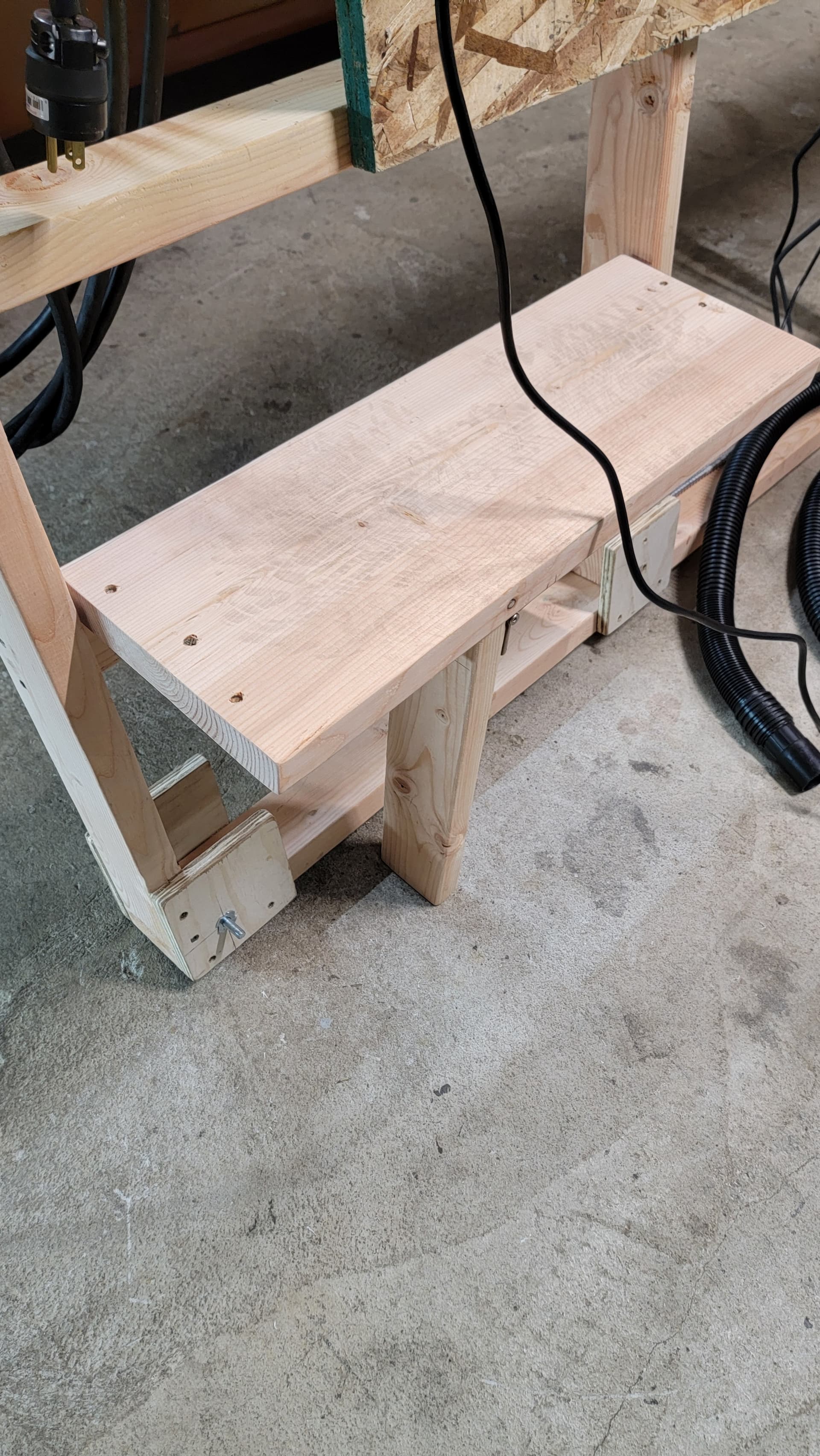

Just wanted to share some of the features of my frame
I built the full size frame using the 8 ft by 10 ft lumber
I put fold out steps so I can reach the top two anchor points.

Love the little fold out steps. So going to steal that idea.
Love the step and the signs. Will have to copy those. Did you have any racking problem with the frame? If so did the bracing you have fix it?
