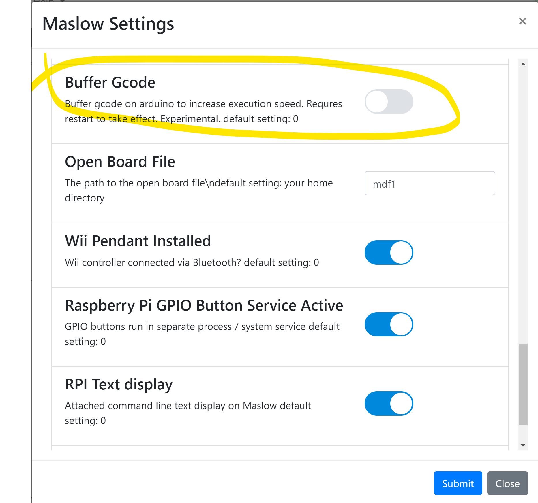

  • Do any of your G3 commands have R’s or just i/j?
  • Can you attach the gcode?
  • Is the buffer enabled?
(menu) settings → maslow settings
GROWTH CHART FINAL.nc (29.0 KB)
here is the gcode. the other files are too big. buffer is not enabled.
