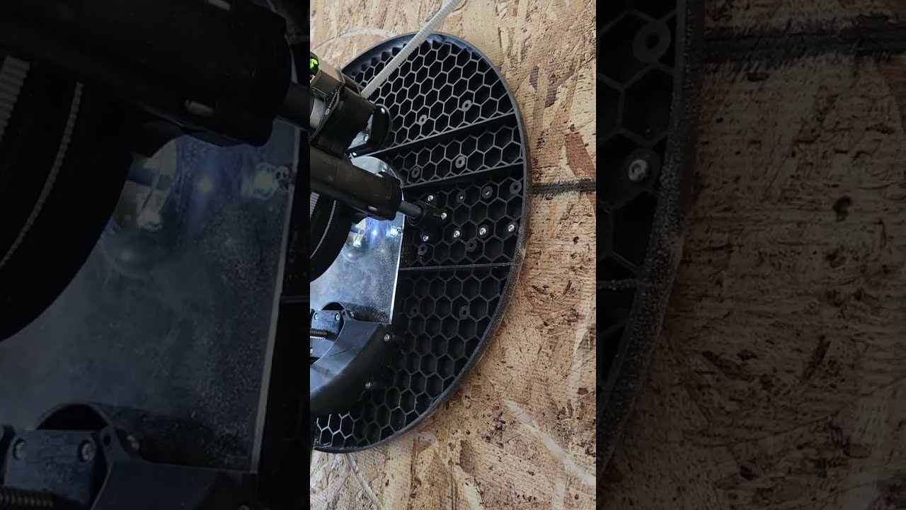

Not sure whether to start a new topic or not, but the larger square had some challenges:
  1. I was driving the software wrong, and moved it to the lower right (-500,-500), then started my cut (I forgot to re-home there)… so the maslow started heading to 1500, 0. I hit stop and it did not stop. I frantically hit stop… still no stop. I had to run over and pull the plug, so lost any log I may have had of this. I did notice that it was logging that the alarm had happened over and over, but it was not stopping.
  2. I’ll find a way to post the video to youtube in a bit for this one; I recorded it. First, I re-set (retract all off the frame, extend all, back on the frame, take slack… move to the start (-500,-500) hit home this time! Set bit depth again, set home on Z. Then I started the cut, which first positions to 1000,0 then goes around the square clockwise. All was great along the bottom. then it started climbing up the left side and the sled was skipping dramatically . then when it got to the top and turned right and engaged again. Good cut also on the right side. Also good news is the distance / straightness was fine. the left side (upward movement) was the only issue with that cut.
  3. I forgot I had set the jog distance to 500 and hit the button to jog a few times to reposition it, realized my error and and hit stop again. This time it did stop and started console logging that stop was triggered over and over. I will leave it there for now; enough excitement for one day :slight_smile:

Below is the whole 1000m cut, and the link starts where it started skipping…
That looks to me like it might need a little bit more angle to the frame?
https://youtu.be/Byf59sBmjaU?t=69
with the original maslow, this is what we typically would see when there was too
much friction between the sled and the workpiece, and made worse when the chains
were too high on the sled. If you have a shorter bit (or can chuck it shorter in
the collet), you may be able to lower the point at which the belts are pulling
and get less of the nose of the sled digging in.
OSB is especially bad for the sled not wanting to slide.
With the older version, some people would get slippery tape (designed for
drawers or to make furniture able to slide better) and put it on the bottom of
the sled to improve it.
with the wood sled, some people also waxed it. I don’t know how that would work
on the plastic sled.
gotcha. I have it at 25% slope unless I did the math wrong, which is certainly possible.
once I go get the luan overlay for this or have a plywood scrap I can test on, I’m also thinking the OSB is probably some of the issue.
I’ll bet it would work great. We wax skis, and plastic parts on automobiles, so why not? Plus I’ll bet the GF reinforced PC is not very slippery. I’ve been wondering if when I get mine, I may want to glue on a piece of laminate to the bottom of the sled, to create a smooth surface that is easy to wax.
In Ron’s video I hear what seems to be RPM frequency changing (slightly) under load. See 2:21 timestamp. I am just pointing that out since the Dewalt router should maintain RPM under load. Maybe I am hearing the frequency change as the mill experiences different OSB strands.
