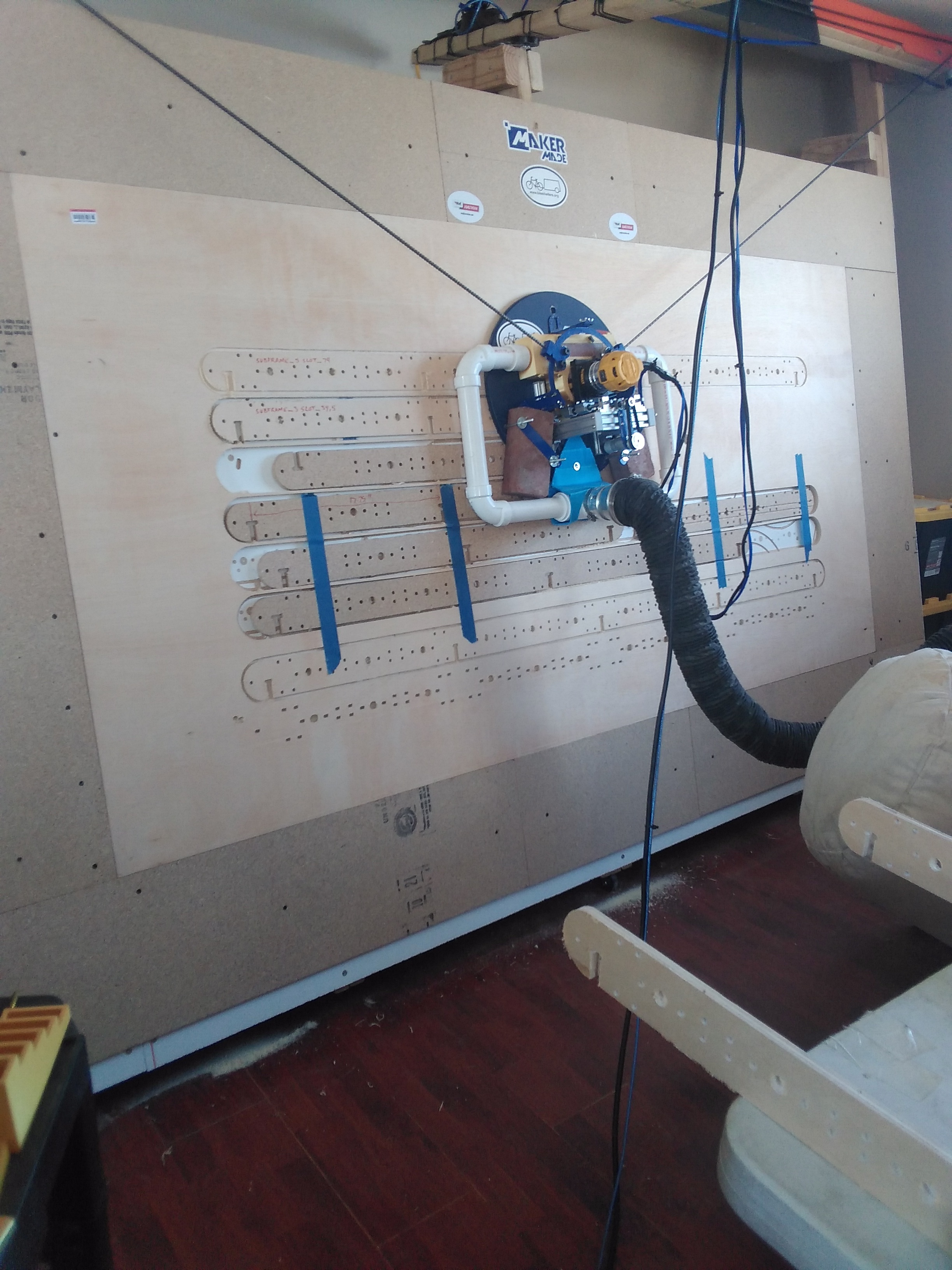

Where are you located? I am not familiar with the current MakerMade product. I have a Due Shield. I’ve never had a problem with it. I also have classic controllers. That said I have dealt with disconnects in many different CNCs. 3D printers,lasers and routers. How long is your USB cable? Is it going through a hub or extension or adapter? Your cutting plastics from what I see. They naturally have a charge and higher potential than woods. I looks like you are screwing the work down. Try adding a ground wire to earth ground on your plastic. PM me if you need help getting a classic controller setup.
I am located in Englewood, Colorado south of Denver. This is a stock first generation Makermade M2 CNC Router kit so the USB cable I believe is 10’ long. I have the USB cable going directly from computer to the M2 control board.
My biggest problem is loss of G-code file during cutting session…I am using Windows 10 small tower desktop computer. This is computer is hardwired to my internet router with a long CAT5 internet cable.
Right now I’m cutting prototype parts from regular cheap 1/2" plywood to finalize designs of upcoming new bicycle trailer frames which are time intensive to cut out on this M2 CNC. I also cut 4mm thick sheets of corrugated plastic (I cut qty3 sheets of 4’ x 8’ at a time) for the external structural bulkheads of these bicycle trailer shelters as well and since those are relatively fast to cut out I haven’t had any major troubles.
It’s these long 8-10hr CNC cuts doing these “test” frame parts out of plywood that are giving me big trouble… almost every cutting session I’ve suffered G-code file loss about 1 or 2 hours into the session. Many of these G-code file drops also required me to recalibrate the machine. This has all made my productivity grind to a halt and greatly frustrated me.
Im open to swapping out this first generation M2 Arduino control board for the Makermade Maslow Arduino control board and switching from Makerverse to Webcontrol… I don’t know if Makerverse or the M2 Arduino control board are at fault here, I can’t troubleshoot beyond where I’ve ended up since I don’t have a Maslow classic Arduino control board to swap in…but I’m open to doing this as nothing else has resolved this G-code file drop problem

but for the disconnection problem i never had this on my setup: i use a raspberry pi linked with the DUE and all work… even if i use it 10 hours: maybe you can try this without changing the control board ?
Maybe the problem is with windows etc…

Is the problem happening with Windows or RPI?
Windows has a USB suspend feature, need to turn that off (should be in advanced power settings). Ensure all sleep, suspend, screen savers are off. Also keep the USB away from any power cord.
