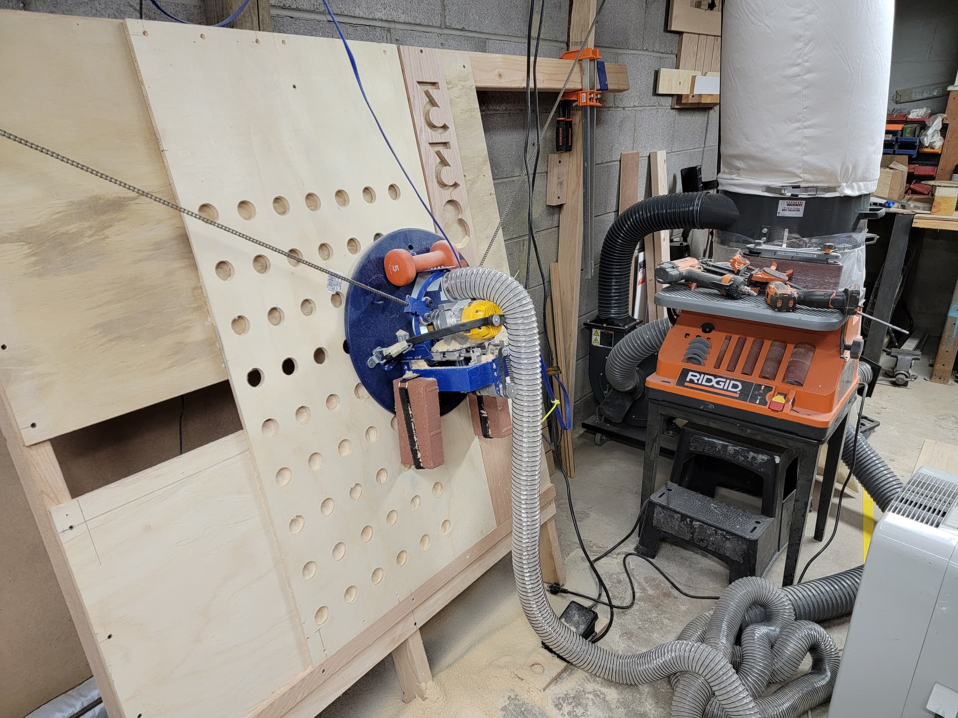

I finally got the chance to cut my panels out. I can’t beleive everything worked out I haven’t had the M2 on the chains even I got two other machines and I needed the space. But… hung the sled built half the frame and it worked perfectly.
