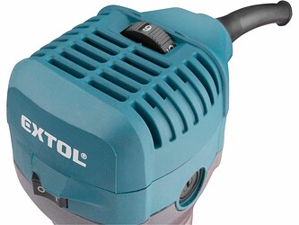

yesterday I assembled my EXTOL INDUSTRIAL 8793302 ( it is a copy of Makita RT0702CX2J) router or rather its spindle into a 3D printing part from Bar - clamp makita. Everything seems very tight and after pulling the spindle does not rotate.
The whole thing then pulled the router clamp.
The locking pin for changing the tool in the collet is inaccessible, but I can probably solve that with a bent wrench, there are key grooves.
My question is about attaching the fan and electronics, the part for the Dewalt does not fit there, does anyone already have a modification of this part for the Makita ribs?
Do you think it would be a problem to simply screw it into the ribs of the router?
look at the router-b-gone thread for an option for the electronics
In m’y case, I juste glued the standard attachement on top of the router with some super glue.

I agree that the Makita adapter is important especially for international. I do have one designed, but I need to do some more testing before I can certify it as 100% good to go.
That being said if you were interested in trying it and giving me feedback I can quickly make any changes that you recommend.
Here is a link to the current design: https://abundance.maslowcnc.com/run/BarbourSmith/Makita-Adapter
Edit: Because 3D printed parts are quite slick I would recommend adding something with some grip like some strips of electrical tape to the inside to help the router hold
