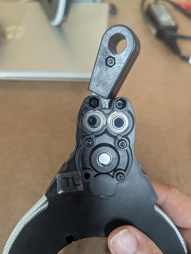

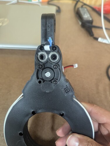

@bar Could you please upload this missing file? When disassembling to sand the bearing surface of the spools several of my rollers were broken. I’m sure that isn’t helping with the friction and increasing force issues.
I don’t know if there will be a 4.2 at some point, but I’d recommend bulking up the connection between the ends of the roller and the body. It might even be advantageous to add a fillet between the body and ends if there’s room.
Can you snap a picture of those if it’s not too late?
Just uploaded it! Thanks for catching that
It’s three of the rollers with the magnet for the encoder.
I’ve disassembled one of the arms to begin sanding. The roller sheared right at the corner.
Since it’s one of the rollers with a magnet, I’m going to attempt to fix it by gluing the ring back on with a section of takeout chop stick in the middle as reinforcement.
What was the belt tension set to when that happened?
It’s hard to tell exactly when it happened, but probably at least 1800.
Are those ‘tails’ of the belts long enough to get between the rollers sometimes?
