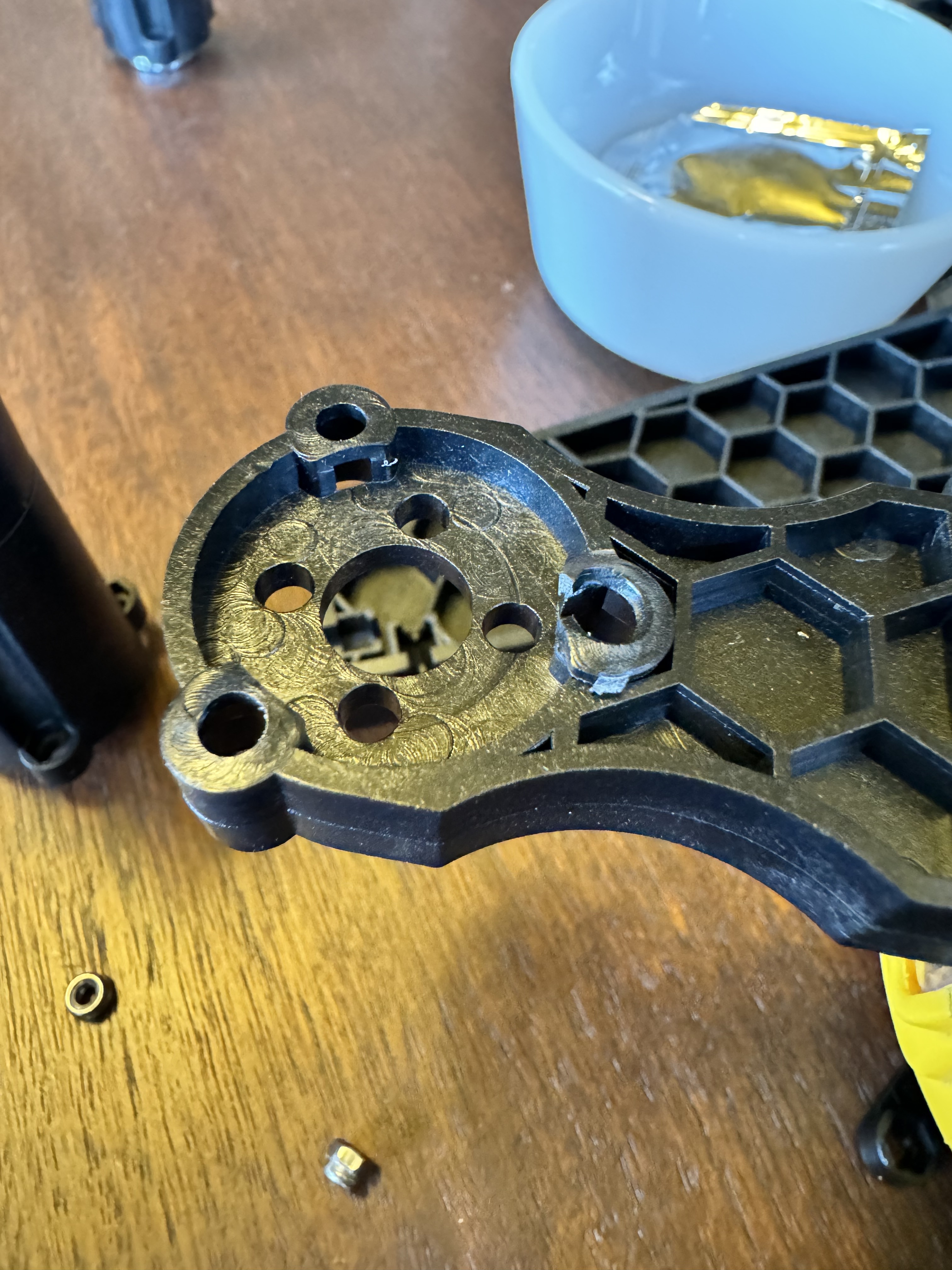

Feedback on the Router Assembly instructions (I think it’s also mentioned above). The instructions about attaching the uprights to the clamp definitely need fixing asap. The single photo and instructions are confusing about which posts the linear bearing posts go vs the non-bearing posts. I did not notice that two of the posts have insets for the bearings and it isn’t described in the instructions. I accidentally tried to attach a bearing post on the wrong arm and the result was that the thin shoulder holing the bolt head tore out. It would be much better to mention the inset for the bearing - if I would have seen that I wouldn’t have made my mistake.
Any suggestion how to handle the damaged arm? My only thought about how to repair immediately is to epoxy in the area and redrill the hole.
Here is a pic of the damage.

The easiest option is to send the address you would like it sent to to Anna@Maslowcnc.com and we’ll get you a replacement in the mail ASAP. If you don’t want to wait for it to arrive the two remaining screws are probably plenty strong to hold until the replacement arrives so you can keep going.
