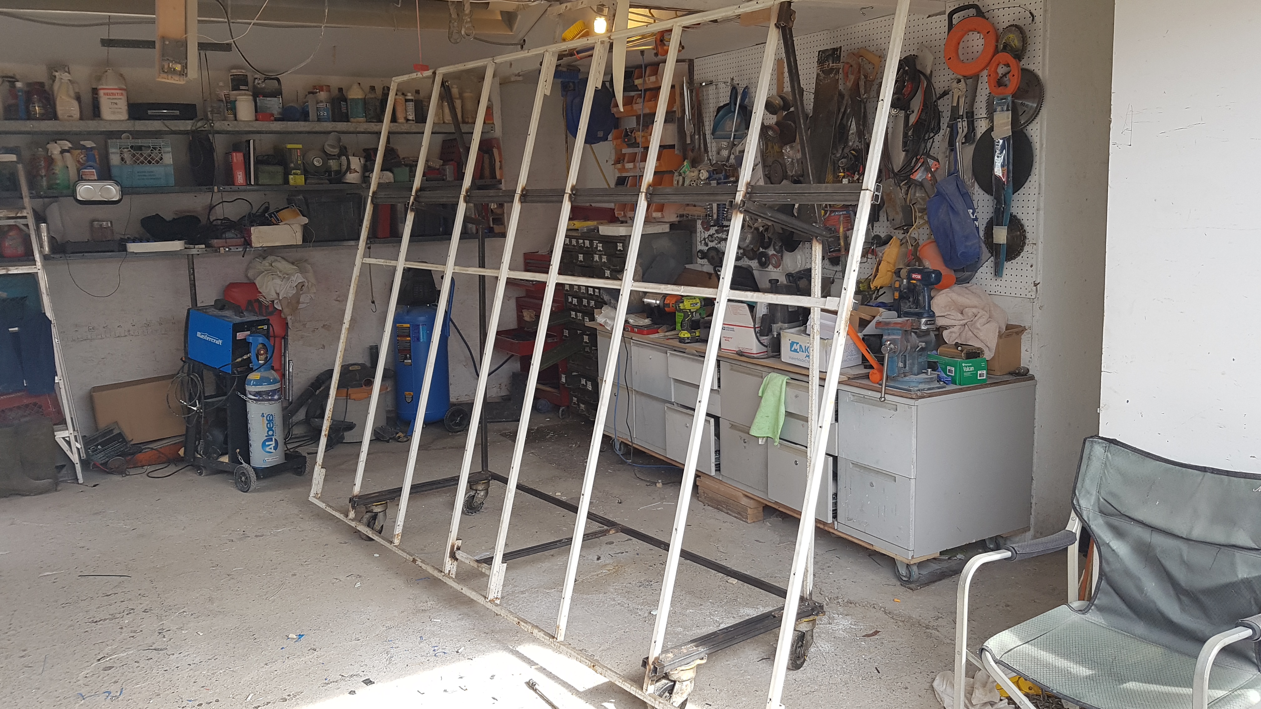

This is looking awesome! I would say for people without a welder/friend with a welder I love insert nuts. It’s a pretty cheap option too!
how wide is your top beam?
The areas I would be concerned about are the top and bottom, where force on the sled would tend to make the gantry rack.
in the bottom corners where force is the lowest, how well does it move to the outside edge compared to the sled riding on the surface? (more mass to move, but possibly less friction).
It would be wonderful if you could space out stock to the right thickness and run tests of the gantry vs a normal sled (all else being equal). How much of your accuracy is in the rigid frame, proper alignment of ring/chain/cg, and how much is the gantry arrangement (and if you want donations to buy you material for your testing, speak up, I’d be happy to contribute)
when doing a lot of cutting, does sawdust/chips on the bottom rail cause any grief?
I think that test results (see above) and picture below addresses your concerns. I took this picture after cutting and putting sled into ā€œrestingā€ position. Part from lower bottom corner are cut as design +/-0.5mm - it is all what counts. About force distribution see my discussion with @madgrizzle above.
Dust is nonsense but fortunately material supporting angle bar at the bottom of workspace collects most of it - you must constantly clean it.
If I understand your question you asking for the width of gantry bar - gantry is 1644x432; see detail drawings in the Garden projects - Maslow MarkII-3D

Great job on the gantry! I was thinking of doing the same idea. I have a good true sturdy frame to start with
. Your tubing is 40mm which converts to 1.575" but here in Canada I could only get 1.5 in. My question is would the printed corners and roller brackets adapt to that size? It’s about 2mm smaller so I’m sure the bracket could be shimmied but is there adjustment in the guide rollers?
Great stuff Robert!
Guide rollers (as you call it - I call it carriage rollers) are independent of tubing dimension - carriage will ride just 2mm lower. You can compensate it with workspace hight.
The corners for gantry will accept 1.5" tubing - I made oval holes on the outer side to allow adjustments in X and Y. The bottom holes (also shifted to outer side to clear ballbearing axis) are used only after final adjustments when you committed to distances. Keep in mind that gantry literally hangs on top bearings and lower guide rail is just a support.
Very important is sequence in which you constructing gantry and carriage - I started with assembling carriage’s three corner rollers; set gantry width to carriage width; add fourth roller corner to resulted width; committed to dimensions by tightening side screws, screwing bottom screws and reinforcing corners with metal angles. My carriage is 340x340 and I suggest at least 15mm thick plywood for stiffness. The beauty of design is that XY tolerances in gantry/carriage do NOT translate to error in cut - cutting error depends only on Maslow arrangement. Router bit position is driven by chains length. Error in Z depends DIRECTLY on accuracy of gantry/carriage assemble.
I am now working on circular saw adapter for ripping and cutting so keep this option open when building your frame.
Good luck and let me know about your progress. Glad to be of help to my fellow Canadian :wink:
