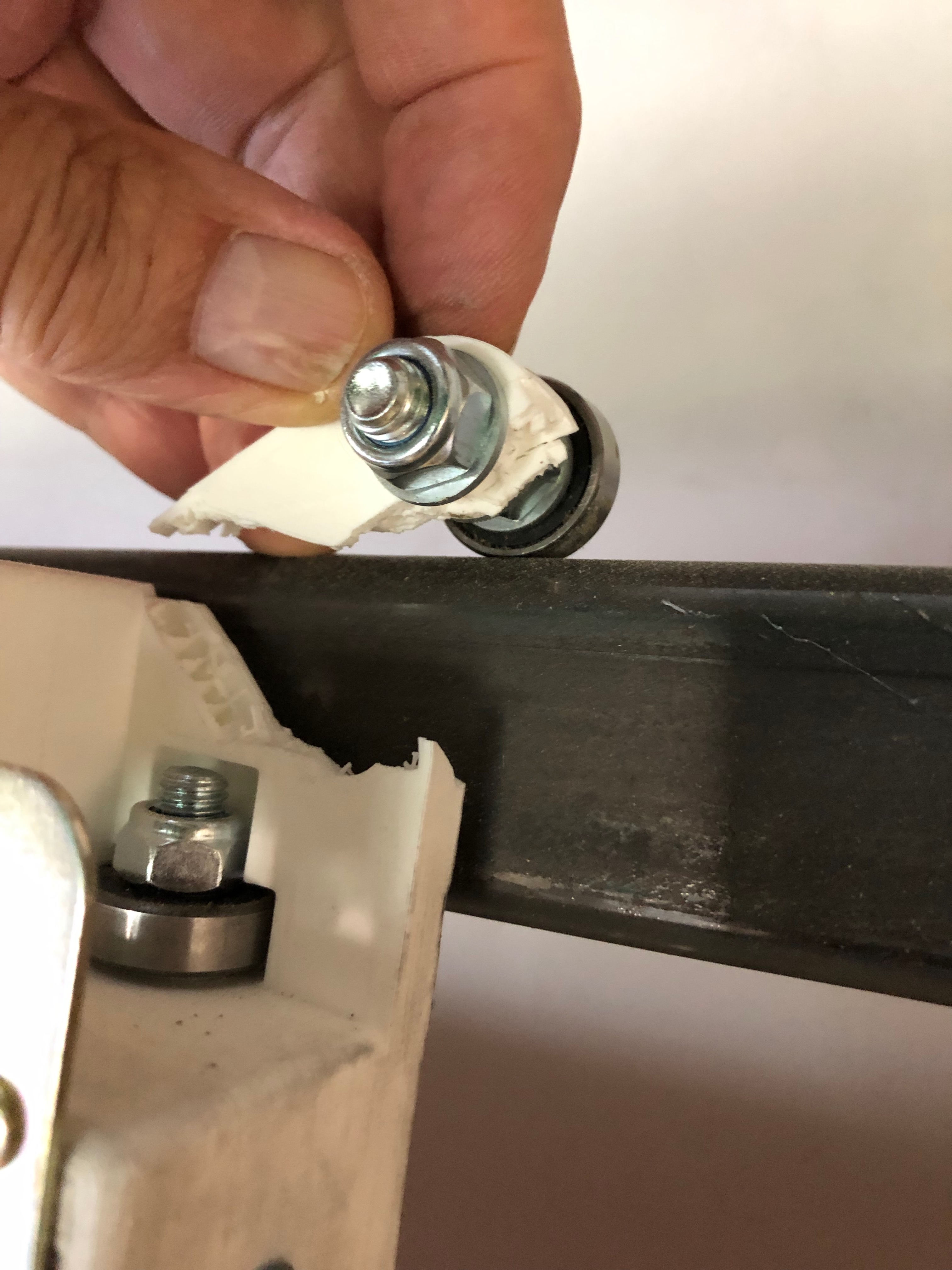

Disaster struck!
I was removing used sheet of 3mm plywood from the cut. Being lazy and rushing, I did not move gantry to the side. Plywood sheet slipped from my hand and sliding down hit bottom bracket of gantry. The TOP piece snapped!
Lesson 1. Do not rush job and always when exchanging material MOVE GANTRY on the side clearing space on the work top. Much easier to handle sheet of plywood/MDF and safer.
Lesson 2. Do not be cheap - I printed my part with 50% fill rate to save time. WRONG!
Lesson 3. What can go wrong, will go wrong. Probability that edge of plywood will hit lower bracket in the sweet spot was close to zero - but it happen. Luckily I have enough PLA so I already printing replacement :wink:
Lesson 4. Maybe printed parts are not the best idea after all…
Some sheet metal might be a good thing to add between printed part and the anchoring points, just to add rigidity. That way in order for the part to break, it would have to break at multiple places instead of the current single point of failure. Also, perhaps add some sort of positive lock that prevents the part from slipping forward off the rails unless you manually disengage it. Something like a spring loaded third wheel that rides on the back of the rail to keep it from coming off?
I have a Markforge Onyx here at work that prints with carbon reinforced nylon. I can even add fiberglass filament as reinforcement. That material would probably hold up better to the demands of your machine.
How big are your parts?
I have Crealty 10 printer and parts size is 120x120x45mm. Is your filament available for purchase?
I might be able to print the part for you. Can you send me an STL file of the part? The filament can only be printed on the Markforged series of printers. And they are a bit pricey for the hobby consumer ($5k to $13K). But the material is really great for durable parts.
I really appreciate your offer - having professionally printed part would be great. I do not want you to incur any cost so let me know how I can pay you at least for material and shipment. I am living in Poland - or you can ship it to my UK address. Please let me know via my email zdm@me.com
Thank you very much

Hello Tom,
Print time is about 17 hours. Will have that done sometime this week. Just have to find a free time-slot on my printer. I sent you an email as well.
Best,
Aymeric
