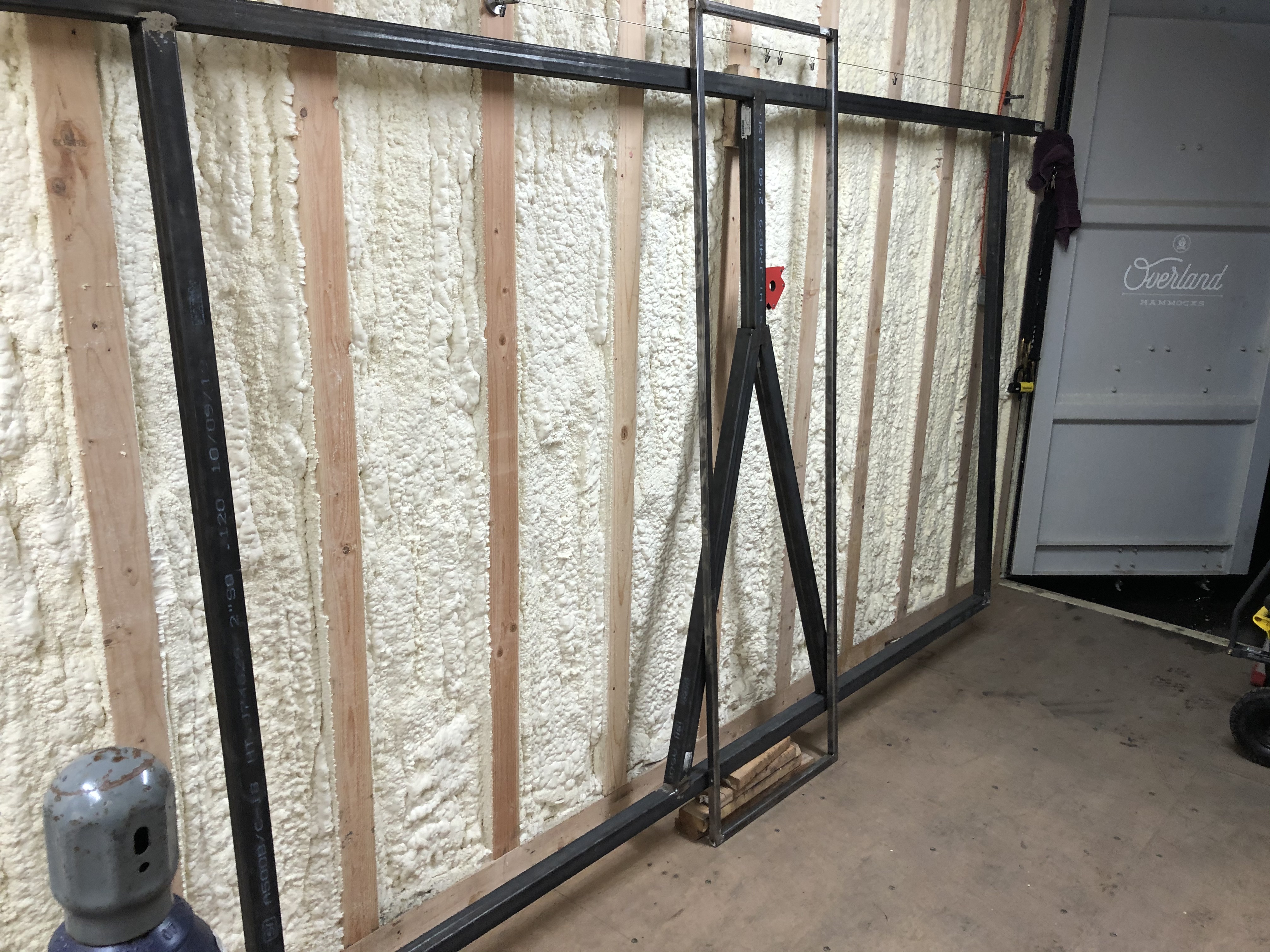

Has anyone pursued this design yet? I am hoping to weld up a frame in the next week. Would love to hear if this works or not as it would be far simpler and more accurate.

I have been working on building the frame for my attempt at building a Maslow Mark II and panel saw combo. It has an overall dimension of 12’ X 7’ which is a little larger than probably needed, but it provides some flexibility on what I can cut. I should be able to cut a full 5’X10’ sheet using the more cartesian focused gantry and sled as was depicted above by jwolter.
I have designed new top and bottom brackets and can post those if anyone is interested.
Here are some images from a fun night welding up the frame in my shop. 2" cold rolled steel for the overall frame and 1" square tubing for the gantry. Sled will be produced tonight so hopefully I will have a “rolling chassis” this weekend.
Much work to do to get the drive mechanisms designed, mounted and functional, but progress none the less.
Way to go @MakerMatt !!! Welded frame looks simpler and stiffer. I love your design of raised brackets - looks that you’ve gained good 50mm in z-axis. Will you use tube to hold gantry together? I do not quite understand function of the bracket depicted in first picture ;-((
