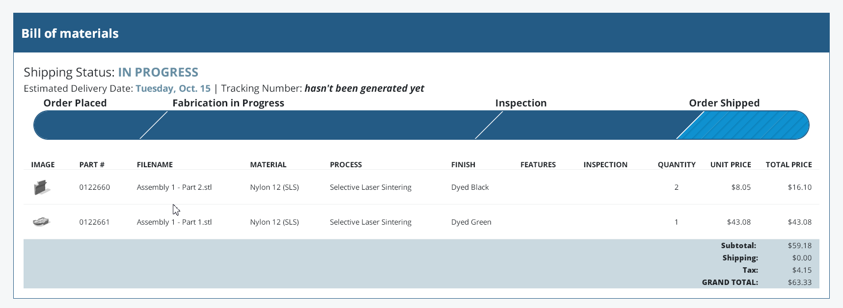

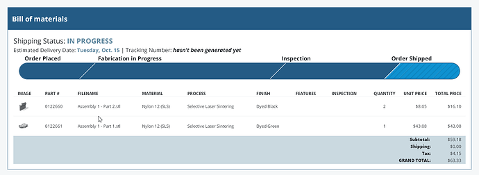

ORDER STATUS
For each order they have this nice status page that was definitely inspired by the Domino’s pizze ordering page. If you’ve ever ordered from them you may recall that if you leave the page open it updates from Order Received > Making your Pizza > Baking your Pizza > It’s on the way
Here is part of my “open order” screen with the neat status bar:

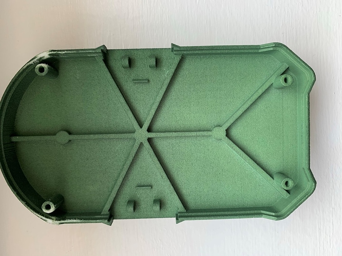

The first article sample of the part came in and the quality is excellent. The finish is smooth and the materials feels very strong. Looks like we got some of the measurements off by a few mm so we have adjusted the design and are spinning a second prototype next week. But overall the experience has been fantastic. I can definitely recommend Xometry and with a US$50 credit to get started it’s hard to beat. Just make sure you use the link above to sign up or you can’t access the credit.
Here are some photos of the SLS printed sample. I’m still waiting on the CNC milled aluminum. Those are due at the end of the month. I’ll share the details when available.

What this 3D printed shim I had printed by Xometry does is marry the top shell of an actual Ryobi battery (removed from one I had) with the bottom of a Ridgid USB charger adapter.
The USB Charger adapter was the fastest way for me to get something that had the retaining grooves and the contacts and wiring in one spot. Makes it very clean and easy and leaves you with a professional looking and feeling setup. You wouldn’t want your big expensive battery to fall off due to weak clip. :slight_smile: You can buy them here: https://www.homedepot.ca/product/ridgid-18-volt-usb-portable-power-source-with-activate-button/1001029549
So from the top down it looks like this:
Ryobi Battery Top (w/Post)
3D Printed Shim & Release Buttons (springs from Amazon)
Ridgid USB Charger Bottom Half (providing connectors for battery & wires)
Any modern Ridgid 18V Li-On Battery
You can get a sense of it in this photo (the USB charger bottom is missing but all but disappears behind the taller green edge of the bottom piece on the left anyway):
As you can see from the photo, the resulting adapter is about the same thickness of a regular Ryobi 1.5Ah (the small ones they toss in kits for free, as in photo above) BEFORE the Ridgid battery is added. Ridgid batteries most commonly come in 2Ah, 3Ah, 4Ah, 6Ah sizes at the moment and increase in height with the large 6Ah picture above. The only material downside I have seen so far (as I mocked this up by hand and tried it out on some tools) is that depending on how large the ridgid battery is, the small extra height of the shim does affect the center of gravity of the tool. So depending on which tool you use and how large a Ridgid battery you add, it could become cumbersome.
