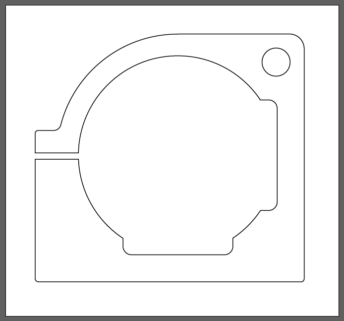

I would love to @cmullins70 but unfortunately I bought these made for the ridgid router since I don’t really have a way to make something like this myself. These are the guys I purchased the set from. I had them machine it for a 92mm hole and it’s a perfect fit and they made it and shipped it the same day I ordered. If you email them directly at chrisclub@gmail.com, their flier indicates that they might be able to do it for a bit cheaper.
Even better! Thank you.
If this is helpful, I sketched up the design in Illustrator for planning out my sled. I don’t have a traditional CAD software at the moment, but this may be useful for someone out there.
Ridgid_clamp_mount.ai (162.5 KB)
