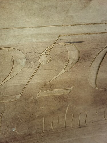

Metal Maslow consistently stops (alarm 3)
Check your xy PID settings in advanced settings and see if they are set to default settings.
my PIDS are original, unchanged. I ran a cut this weekend hitting pause and go everytime it crashed and this is what i achieved. cut lines ripping through my work, maybe this photo will help someone recognize whats wrong.

As the picture above (my previous post) shows, the errors appear to be happening after a Z movement. Someone once suggested to put a pause in between Z movements, but I havent a clue how to do that, or why i should have to when nobody else seems to have this problem.

I fixed my problem, it still happens once in a great while, but i am always able to restart it without fail or damaging my cut.
The fix? i turned my plunge speed down to 3in/min suggested by another post somewhere, and it worked instantly, though that was wildly to slow to be useful, so i slowly cranked it back up to 7in/min and it still worked, so i stopped there. it was originally at 9in/min which does not do well.
