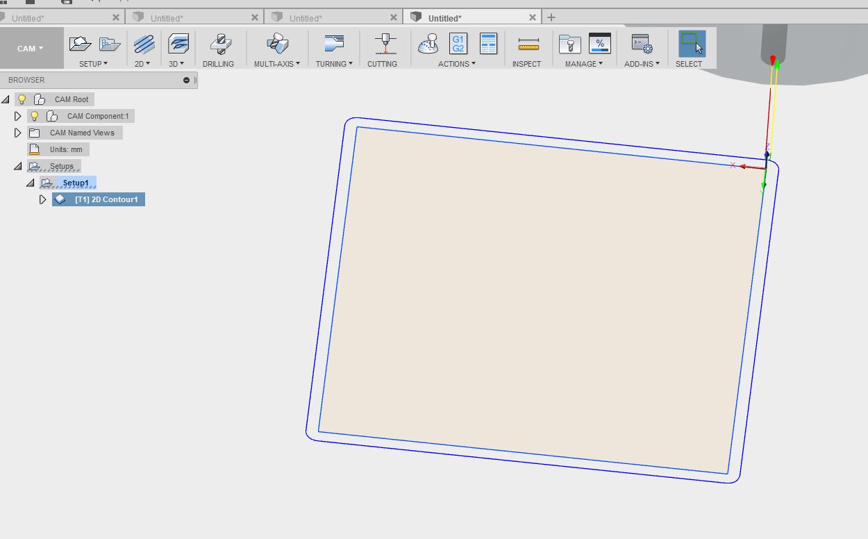

I did raise my top bean 12" yesterday. Still have the stutter although it has changed ‘frequency’. It seems more widespread out (wider) than before. The sled still hops up at about a 10-12" interval as it moves along the top of the arc. This seems like a communication break. I’m using the Rasp PI4 webserver.
I have gone back to Fusion to simplify my arcs, but there is no improvement.

My drawing file was created in Autocad, then ported into Fusion. I also used Inkspace to create an svg file that was converted in gcode. Then I tried importing into Easel and exporting its gcode. I used David’s gcode cleaner. It greatly reduces the file size, but I still get jitters. Not cutting anything, just doing air cuts with weights that approximate the routers weight.
