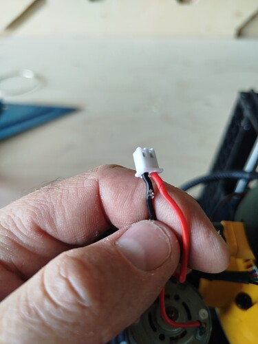

My dc- motor wire has a small cut
Just got my maslow and assembled it, only to discover that one of the dc-motors wires has a cut, so only three motors are extending and retracting.. are these wires easy to fix/replace?
I’m sorry about that!
They’re pretty easy to fix/replace if you feel comfortable soldering, but if not I am more than happy to send you a replacement. I will DM you a code for a free one right now.
