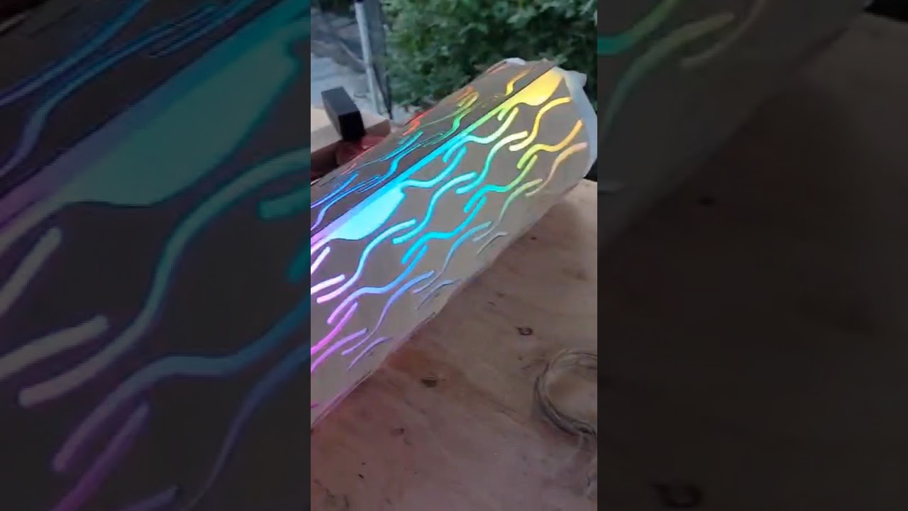

Initial outside design
Once the box and disks were glued together I cut out the outside using a custom kerf bending design. The initial design looked a lot like wood but the pattern was very complex and it created a lot of small chunks of wood that clogged the vacuum.
This kills the maslow. I’ll talk about this later. It also took over 3 hours to cut one part. We were aiming to build 27 segments and we had a tight deadline of 2 weeks. So we simplified the design to be cut with a single engrave pass with a 1/4 in bit.
We then sanded everything and glued parchment paper diffuser on the inside. Then rolled the outside pattern around the disks and brad nailed it to the disk.

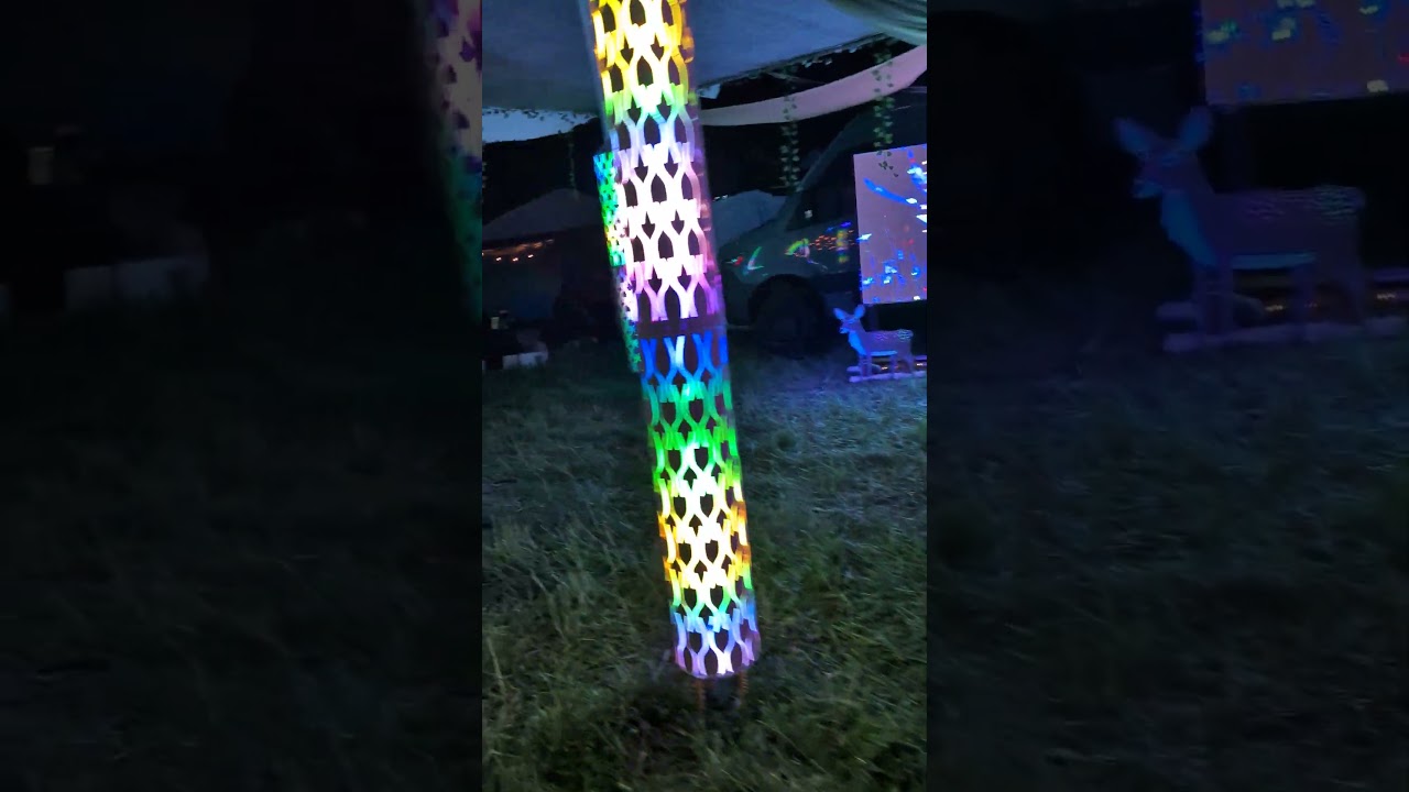

With a ton of help from my campmates we built 17 of these which was plenty for our stage because of a math error I did in the initial estimation. We were basically running the Maslow non-stop for about 2 weeks. We encountered a lot of issues and we must have taken the Maslow apart about 15 times during this period! I am also glad I bought a whole new 4.1 version so I could swap parts.
First Light!
Video of the finished stage
