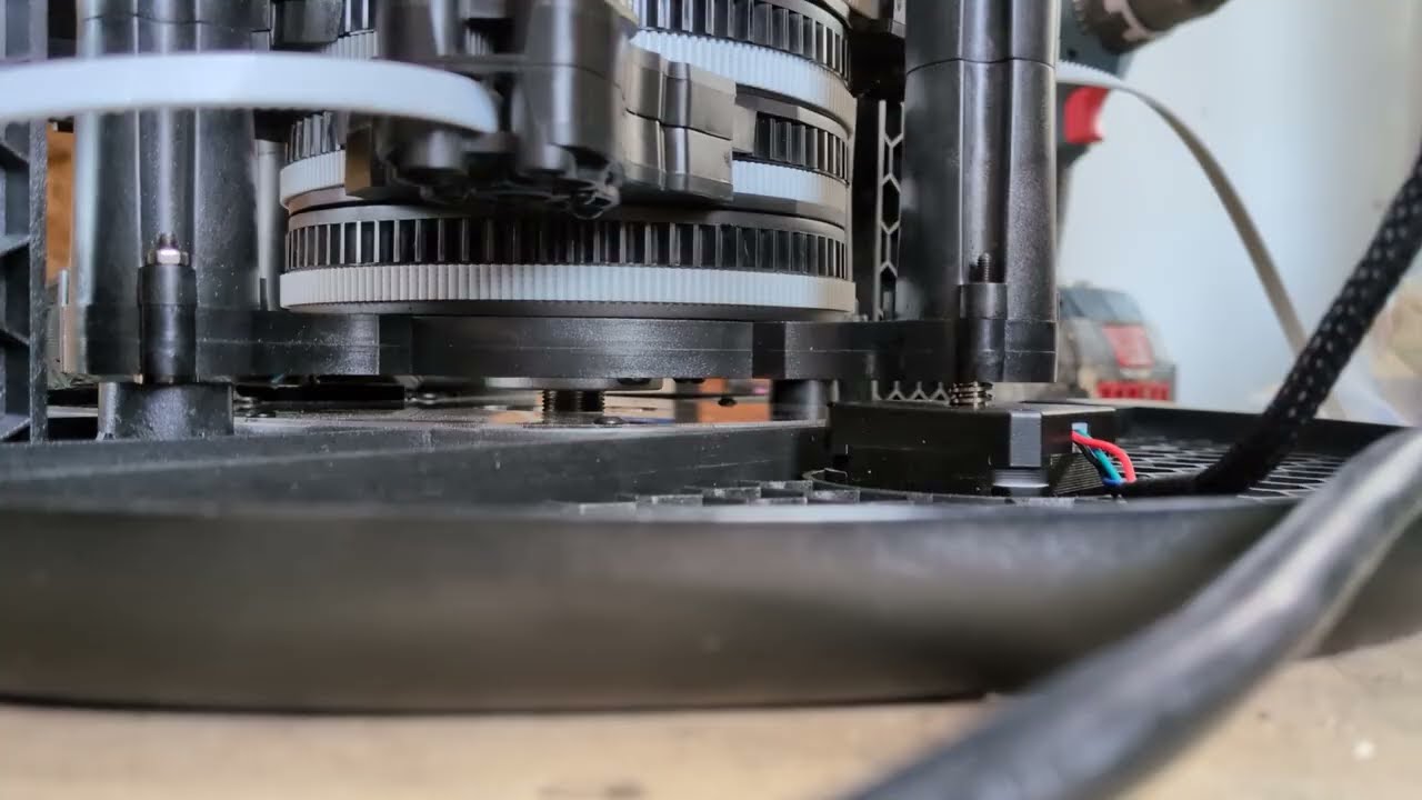

A tangent here: when I calibrated, I had trouble with one threaded rod for the Z-axis bottoming out before the other. A video of the issue is below. Can anyone help? Is it something to worry about?
Another tangent: when I constructed the frame, I put in long threaded rod and multiple nuts locked together. The idea was to set each anchor point to match the Z-axis height of the respective arms. I lowered each anchor point though when I realized it might help alleviate the lifting of the sled in the corners. (I also gently and very carefully pushed the sled against the cutting surface while it was carving to keep it flush against the cutting surface.)

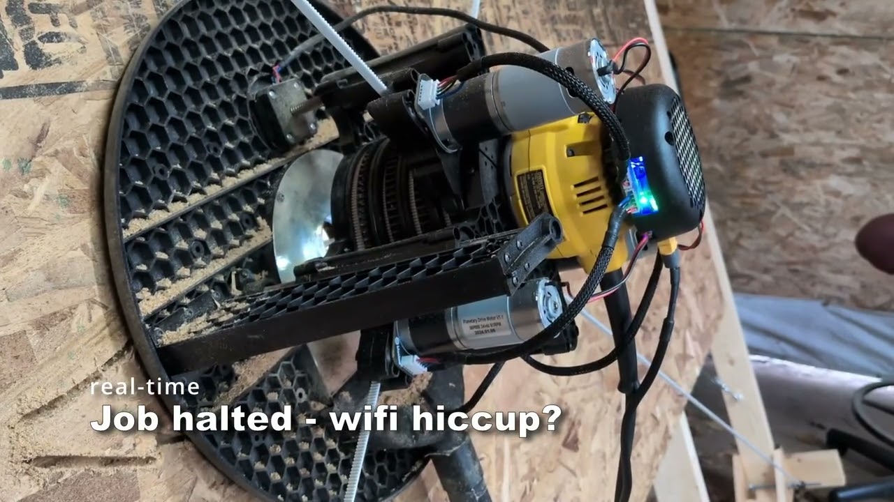

And then it paused in the middle of the job and repeatedly plunged in and out. Does anyone know what causes this teabagging behavior? Is it a result of a wifi disconnect?

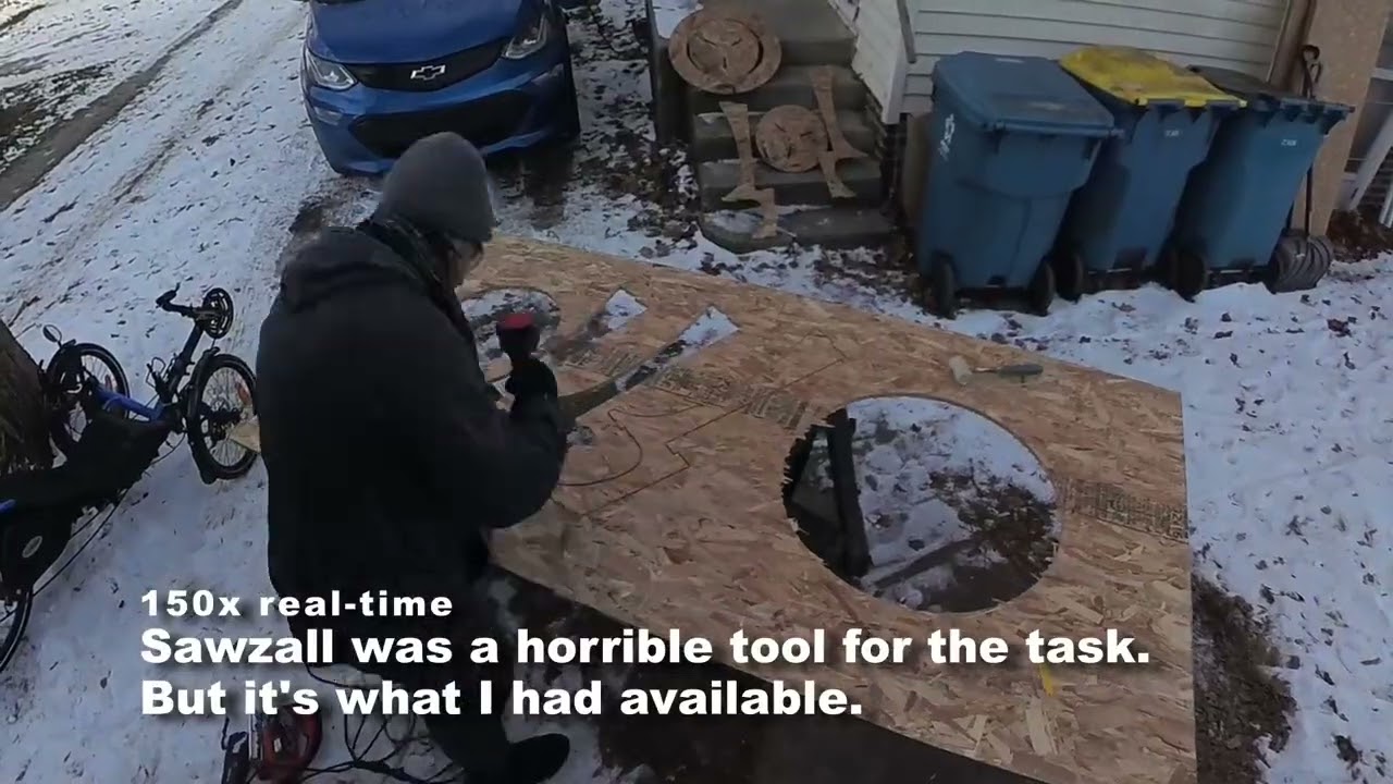

Removing the parts from the sheets was pretty annoying. This is a step I expect to improve greatly with more experience. I’ll have better material next time. I’ll carefully measure the actual thickness next time. I’ll babysit my laptop and the machine better next time (and probably tell my laptop to forget all its other wifi networks and never sleep.) And I’ll have sharp jigsaw blades, an oscillating saw, and a pull saw.
This time though I only had mismatched saw horses, a dull jigsaw blade, a sawzall, and an oscillating saw. It was cold enough my fingers hurt. And I had several parts that weren’t completely carved out.

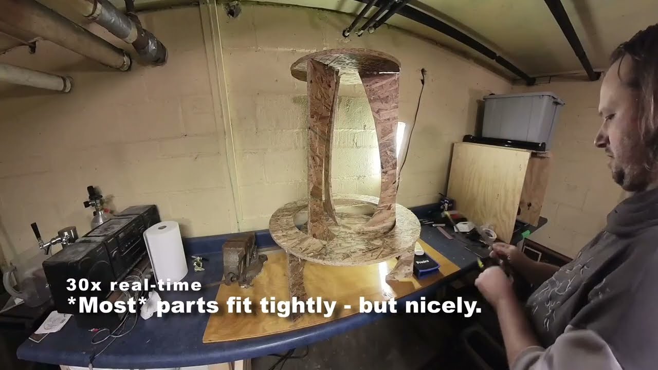

I brought the extracted parts to the warmth of the basement so that the wood glue I used would set and cure. I also used a vice and files to “smoosh” and sand the tabs closer to the nominal thickness. Then I used a soft mallet and eventually a sledge hammer to persuade the parts together. I spread wood glue by finger on all the tabs and the parts that would meet with the flat of the discs or ring.
The hand finished third leg was especially difficult.

And my design has a flaw. When you step on the ring to sit on the stool, too much of your weight is beyond the legs of the stool. I could have redesigned the ring (maybe made it triangular?) or given the stool 4 legs so less of the ring would extend beyond its footprint. 4 legs wouldn’t have even had to wobble. (https://youtu.be/47YbLU7-J1M)
I may add 3 additional legs at the halfway points between each current foot on the ring. I think a six legged stool sounds dumb but I’d like this first project to still be… sit-able.

Try loosening the screws holding the motors to the sled and winding Z all the way up and then down. When you get to the bottom tighten the screws.
I am really impressed with your decision to dive in the deep end and just give it a go.
Two things to consider if you are raising the belts to match the arms:
  1. You will need to let the machine know what you have done. You do this by changing Z values in the maslow.yaml file.
  2. Posts need to be rigid, threaded rod will bend enough to throw your calibration out if not supported. You can 3D print supports or use a wooden block to restrict movement of the post. The belt end needs to be free to rotate easily.
  1. Thank you! I’ll look into where I would update the values in the yaml file. This would be Maslow_tlZ, Maslow_trZ, Maslow_blZ, & Maslow_brZ right?
  2. The threaded rods are very rigid. They go through both sides of the frame and even when the sled changes direction at its fastest, the rods don’t bend a mm. I was concerned about the damage to the belt ends as they rotate on the threads. (But they move pretty freely.)
1 That’s right, FluidNC pull down then Setup. Update, Set & Save each one.
