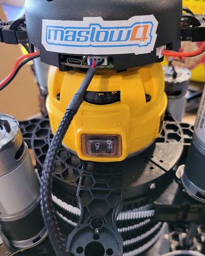

Thanks! I think I know where you are talking about for sticker location…but since I had only one I found another place that it seemed to fit nicely in the middle:
Support from you guys and the forum has been awesome!
You know, this is an even cooler placement! Thanks!
