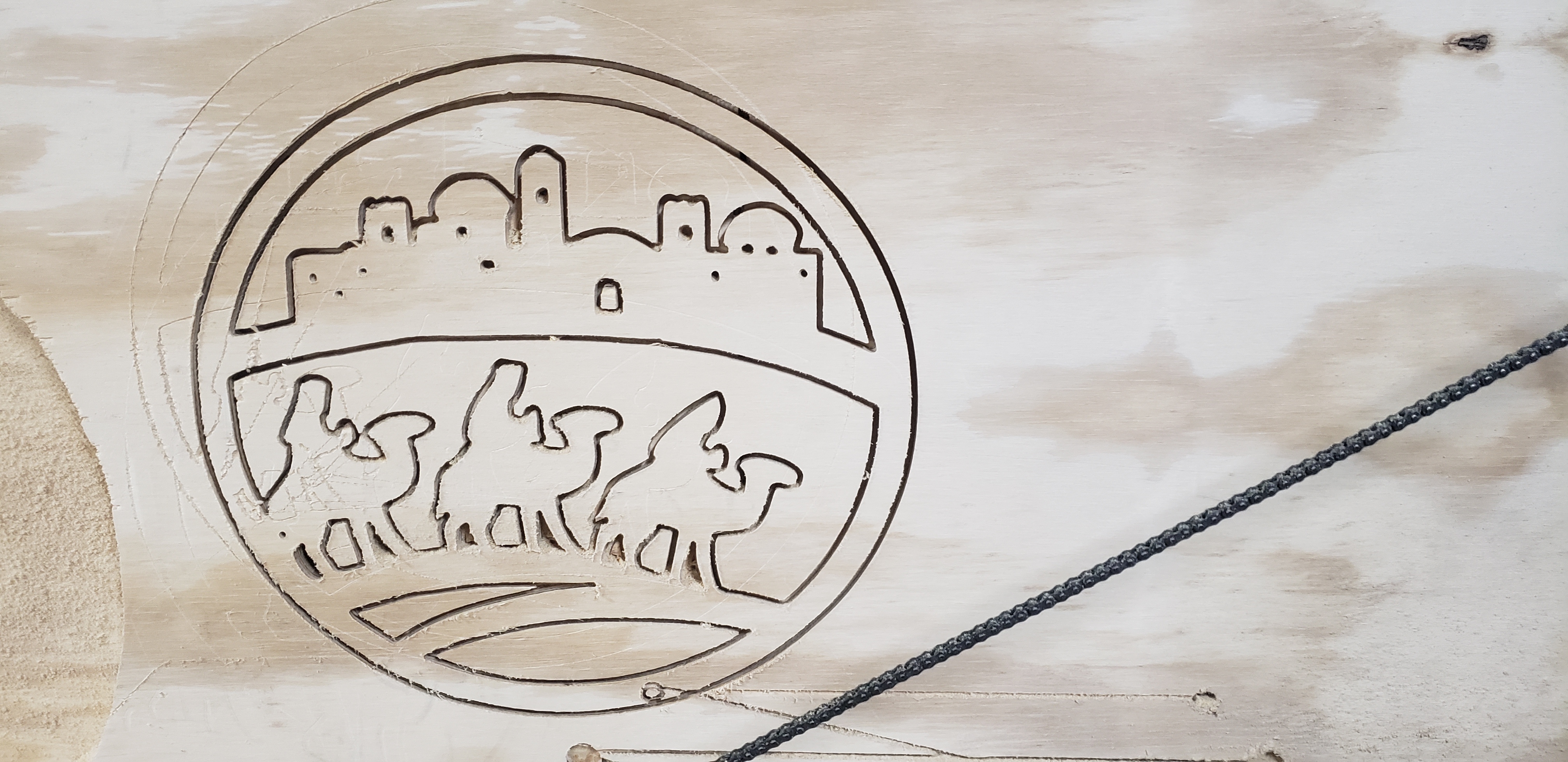

First carving
One thing is for sure, you have to read, read, and read some more about everything involved before hitting the power button.
