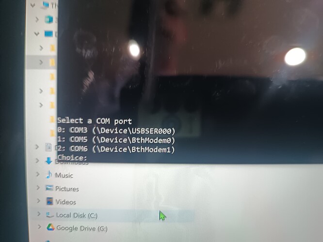

You can fully reinstall everything back to factory settings using the USB port and a windows computer if you want. That would also set everything back to the defaults
I am at a loss, I have reset everything and still nothing. I have no idea what the blue lights blink for a . so I can’t manually go to a page. How do you do it through a USB cord?
Do you have a windows computer? I can send you the file to reset everything over USB
Yes I do.
If you unzip this folder and then double click on “Full Install.bat” with the machine plugged into the USB port it should re-install everything and set it all back to the defaults
Have a feeling this is windows BS but… Any ideas? Maslow is plugged into the wall, USB is plugged in.
Did you extract the contents to a folder before clicking on the “Full Install.bat” file? The screenshot makes me think that you double clicked on the zip file to preview the contents.
Well it was extracted but must have hit it in the zipped folder. When I click it in the extracted it started working then I got to this page and don’t know what to type.
Oh snap it is starting to come around. I was able to get in, I updated the yaml file and in the middle of the firmware. Do I need to update the index file where I did the yaml or where I did the firmware???
That file should have installed the latest of everything so no need to update any of the files :grinning:
