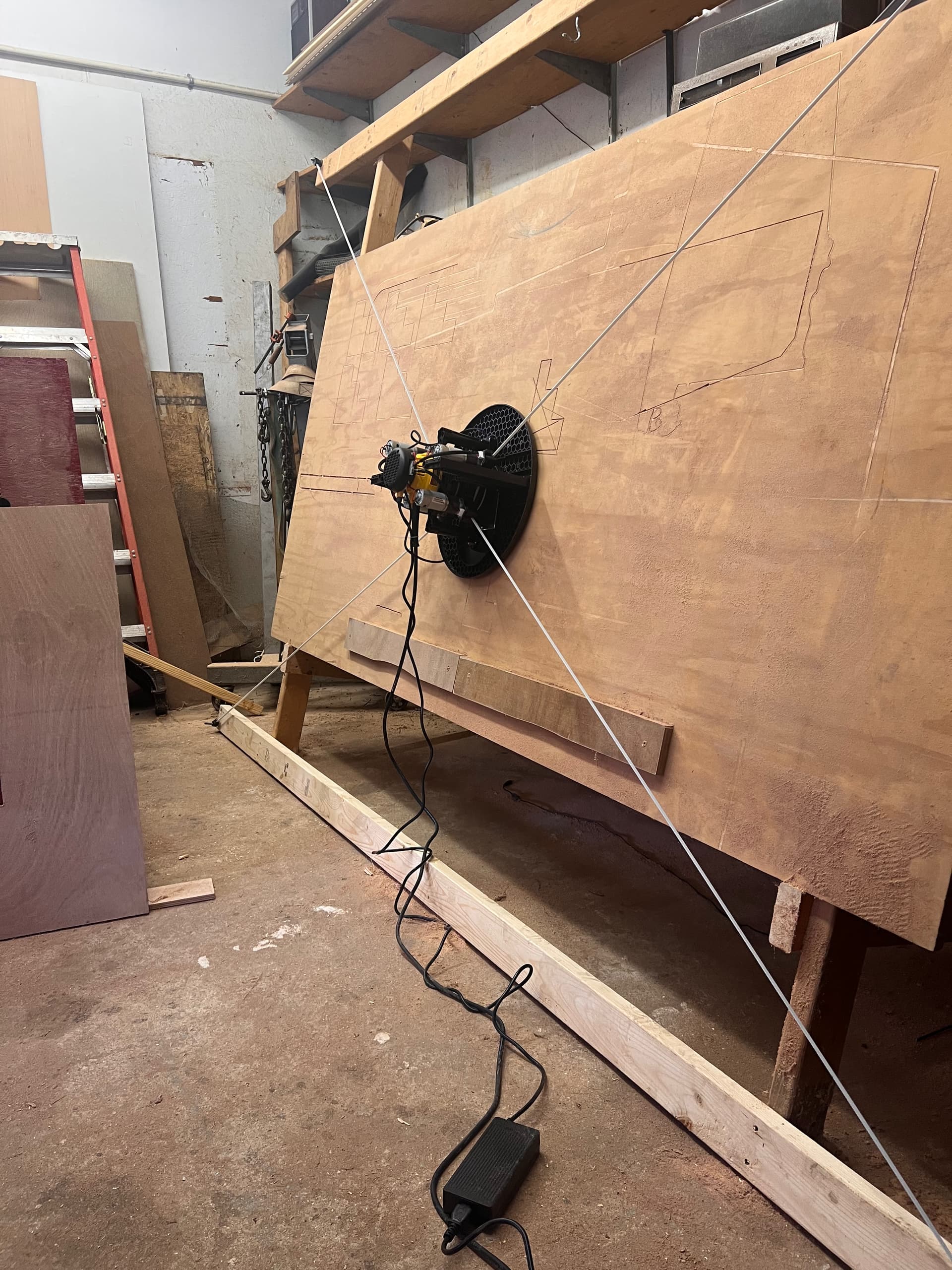

When I turn on my router it doesn’t always connect. It takes several minutes, then much of the time I will get a message that the connection has been lost. It happens so frequently I’ve not been able to complete my initial calibration.
Anyone have any ideas?
This ias as far as I’ve been able to get. Once it tightens belts it doesn’t do anything else.

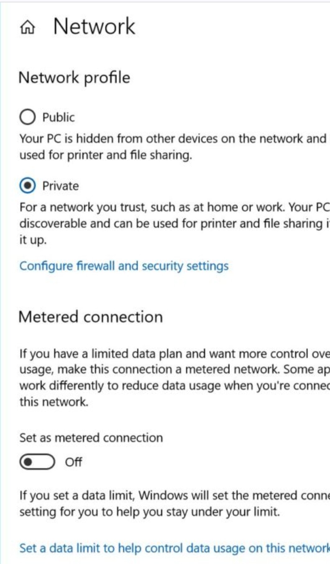

Try to go into the FluidNC config before you loose connection and set it to AP mode. Also check that your network profile is set to private and not public of your on Windows.
Thanks for your advice! Where would I find the network setting for public/ private?

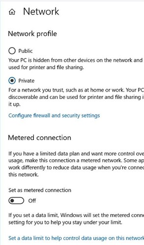

Click the network icon in the bottom right corner of the screen. Then right-click the network you are connected to and choose properties or settings. You should get something looking like this:
I was having issues when connected directly to the Maslow as an AP and found that it was set to public. Changing to private fixed the issue.
This doesn’t happen as often with connections to home WiFi, but since the Maslow doesn’t let you connect to the Internet via it’s own network Microsoft thinks it might be iffy and sets it to public.
Worth checking either way just to be sure.
You can also search for “change network profile Windows” if you can’t find it. On my phone, so I don’t have the correct path in front of me at the moment. Memory is failing at 2am :joy:
