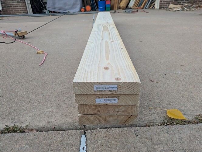

The hardest part was lining up the eyebolts in each board so that each set of two (four inches apart) was stepped down by 1/4 inch from the set before so that they all would fit together stacked in the center. Picture below
I had to round the corners so that they would all fit with room to change the angle of the X
It is important to go through BOTH links when anchoring the corners for accuracy. Later I marked the links that I used with marker so that I could find them again.
