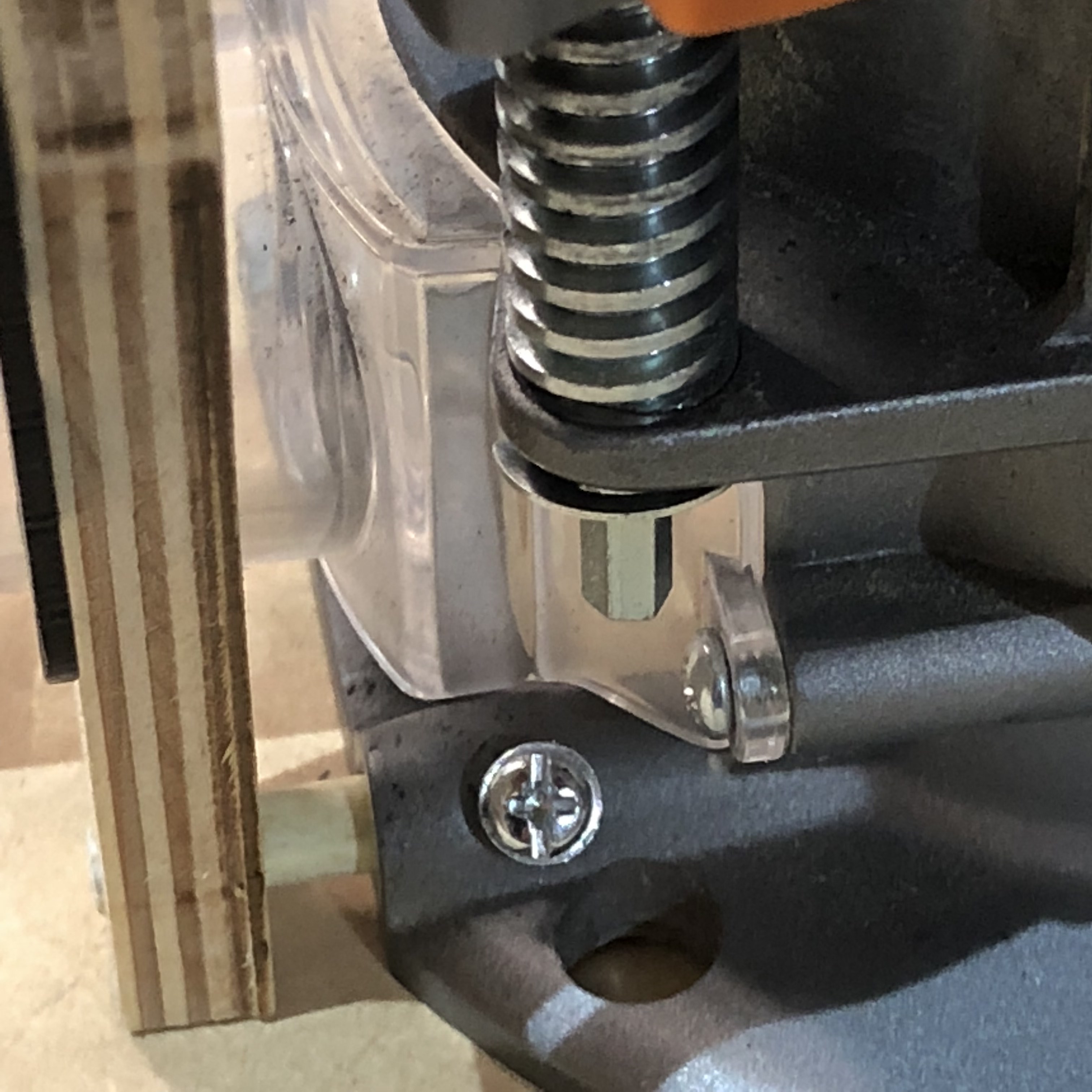

My router base has a place to attach a horizontal rod for some of the jigs they sell. I made a bracket for my z-axis that attaches to that, so the z-axis bracket isn’t in the way of any of the linkages, and comes with the router base if I change sleds.
That is so slick @blurfl!! I didn’t even consider using that hole as an attachment point…brilliant!
Is that the recommended Rigid router? If so, that’s awesome and I will definitely be copying that!
Do you have another shot of it from the vacuum port side? Just wanted to get a look at the shape you made the plywood. I figure no reason to reinvent the wheel if you solved it already.
That shape was to avoid one of those symmetrically-placed weights I mentioned :smile:. Nothing special about it. I did have to search to the bottom of the old-screw bin for the set-screw, it’s a metric thread, not sure of the size. A screw left over from some IKEA kitchen cabinet handles fit.
Good to know it’s metric, I should have something hanging around.
Great idea @blurfl :slight_smile:
For future reference, it’s an M4 thread. Strange that they mixed metric and imperial on the machine (the router plate uses #10-32 if I remember correctly)
