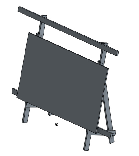

yes, Just about anything that puts a solid 2x4 between the motors will get similar accuracy
but you can make the sled from a 2’ square of plywood :wink:
if you took the plywood off, I would expect the machine to collapse

let’s talk about what the differences are.
your version is
  1. missing forward facing boards to move the chain tension forward
    simple gap, but it means that you need two more 12" long boards
  2. has far less structure (will not stand without the plywood
    • no rear support bar
    • no horizontal or vertical structure behind the plywood
    • nothing to prevent racking other than the plywood
  3. support for the plywood other than at the outer edges
    • I think this is a noticeable gap, especially for people in areas with humidity
  4. replaces the angled arm with the top beam on top with blocks that you bore through.
    • you show two bocks, but if the front of the top beam is going to be just over 6" out from the front of the frame,
    • you will need 3 on each side.
    • This means that you need 11" long bolts.
    • I’m worried that the stack on the two sides will droop unevenly (non-straight holes in the legs, slop in the holes allowing the bolts to angle a bit more)
    • It’s much harder to put a piece of unistrut on this design, as you have to drill through the side of it (or rotate it sideways, which weakens it)

The version we have been talking about also eliminates the temporary frame entirely. It also eliminates the need for the plywood (you can put whatever you want as a wasteboard there, including foam, and easily change it out)
What is it that you see as more attractive in your version?
Looking at the design, I see one bolt at the top of each front legs and two screws at the bottom of each front leg (where the lower cross brace is installed). The top can easily rack and though the two screws at the bottom are better than one, it’s not much. I don’t expect the machine to collapse on its own, but I could see the potential of it happening when trying to get a sheet of 3/4-inch ply on it.

It’s hard to compete on a feature-by-feature basis because my version is just a stripped down minimalist design based on yours. I think that there is value in giving everyone the minimum possible design, and then giving everyone the option to make something more complex if they feel up for it.
I don’t think this is a ā€œone or the otherā€ type of thing. It’s more of a what is the absolute minimum we can build, then offer the option to improve it. Take the current design for example which has spawned a whole host of improved versions. I think having a well documented design like yours out there with assembly instructions written for it also and giving people the choice would be a great thing.
Here are the two designs as I am thinking of them:
To address specific criticisms:
I would expect it to stand well without the plywood. I will build it to test, but while there is nothing to prevent racking the legs would easily stand to with the plywood removed
Yes, I haven’t quite decided how to do that yet. I keep thinking there is an elegant solution that I haven’t thought of. Two 12" boards would do it, but I’m hoping for something cleaver :wink:
I don’t have a lot of experience with humidity. Technically the humidity is always high in the NW because it’s always raining :upside_down_face: but I’ve never experienced any plywood warping. This is a good point and duly noted.
I actually think this is a big strength. In my testing the bolt-through type of connection here was the strongest and easiest to build. Because all of the surfaces referenced are factory edges it gives a good consistent result regardless of the skill of the person assembling. From my calculations based on measuring my old machine you would want an extra 3/4th inches of distance when cutting 3/4 plywood, so adding a 3rd block would put you over by 3/4th inch. I don’t think this dimensions is critical. I think maybe we are thinking about this connection differently. The bolt is really doing no work other than pulling the blocks together really hard, all the strain passes through the wood. The size of bolt hole doesn’t actually matter, in testing I drilled them all a size too big just to make putting the bolt in easy. Everything was loose until the bolt was tightened, then rock solid.
One last strength of this design is that the edge cuts are never referenced. I try to assume that all hand cuts and measurements are good to within about ±.25 inch which I think is reasonable for someone using a hand saw. If one part were to be made .5 inches longer than another in this design everything will still fit together. Having one leg be 1/2 inch taller than the other would not be ideal, but the distance between the motors will stay constant and the triangular kinematics will not be affected

remember, these legs don’t have the 3.5" wide base, they are narrow side on points (at least until things wear down a bit). If the bolts are very tight, then you have a fair amount of force to prevent racking, but if the bolts are even a little loose (see discussion below, I seem to be replying from the bottom up :slight_smile: ) you have almost nothing providing rigidity. the 2’ kickers give someone who trips over the back a LOT of leverage against the bottom beam to loosen the screws there.
I would also expect it to stand fairly well when new. My concern is after it’s aged for a few years and screws/bolts have loosened a little bit, and the plywood has gotten chewed up. Now the person goes to remove the plywood (with the sled hung from the top beam) and the frame comes crashing down.

This difference drives a lot of things. If we weren’t trying to provide solid support for the plywood out a long ways, we could put the legs closer together, which would make the crossmembers shorter… this has add-on effects, which is part of the reason my alternate2 frame used less lumber than the current alternate 3 frame does. This design has them 83.5" on center while my alternate2 design had them 55.5" on center.
making the design solid without any plywood attached requires a crossmember and diagonals, not complex, but a couple extra steps. I’ll admit I didn’t initially see the point, but the idea of being able to use really cheap sheets of foam as the wasteboard, and doing something like hot glue to attach it to the frame sounds very nice (1/2" foam is weak and flimsy, but at 1.5" (3/4 ply + 1/2" wasteboard is 1.25"), it’s easily strong enough, given this design.

A large bolt through 4 layers of flat 2x4 and end on through the long side of a 2x4 is very strong, but did you actually glue the right angle joint? or just screw it?
But as I see it, it’s going to have the most variation in the resulting height of the mount, between the question of the exact location of the hole in the top beam and the leg, and the probability that it’s not going to be completely straight is high.
I expect that for most people, they will be able to move the mount up and down by an inch or more while the bolt is loose. Where in this movement everything ends up when the bolt is tight is going to vary based on a huge number of variables.
Bolts also have a tendency to work loose, especially when used to clamp wood and the wood expands and contracts (as the wood expands and the bolt doesn’t move, the wood dents where the bolt rests, then as the wood contracts, the wood that dented doesn’t expand, so the bolt is now loose. In this case, with cheap lumber, the bolt is attaching in the way that is going to move the most.
by comparison, the ā€˜ugly’ process of taking to factory ends and attaching them at a right angle with glue and a clamp, then driving four screws through it is trivial by comparison (and woodworkers reading this are cringing)
and it’s a lot easier to mount unistrut on top of arms rather than having to drill a large hole in it for a big bolt.
