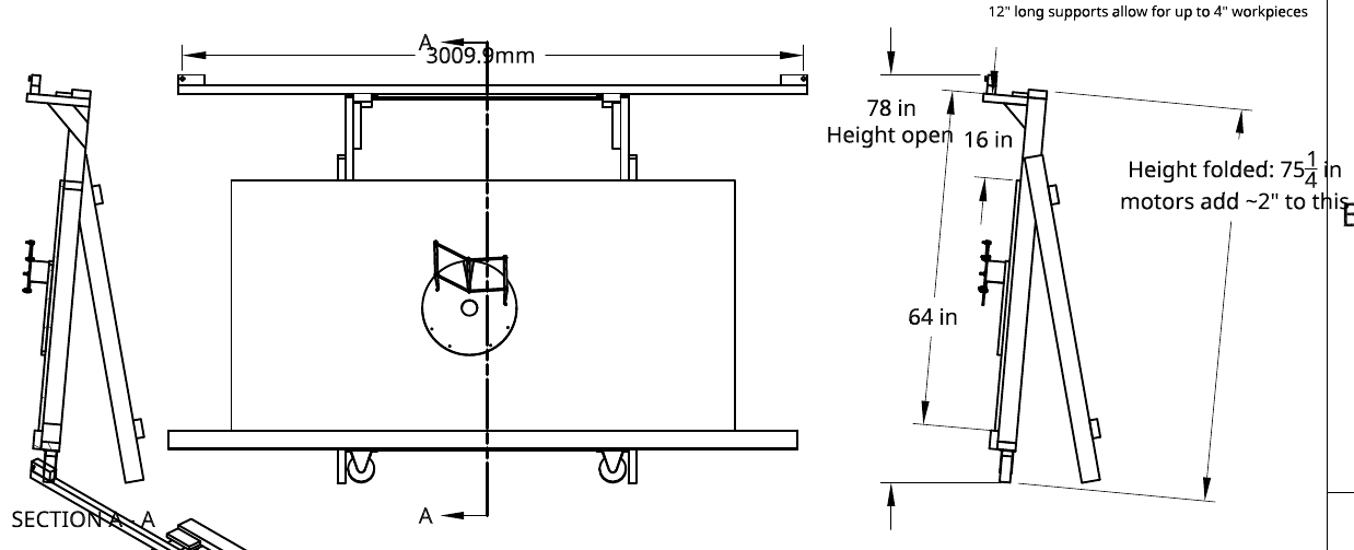

@therayster at 33" out, 10 degrees means that the chain drops 5.6", so here is a tweak (the brace only goes out 8" instead of 12" and the arms are on their side rather than edge)
with unistrut, this is 3" + motor mount/sprocket height, for a 2x top beam on edge, it’s 5", so there would still be a problem.

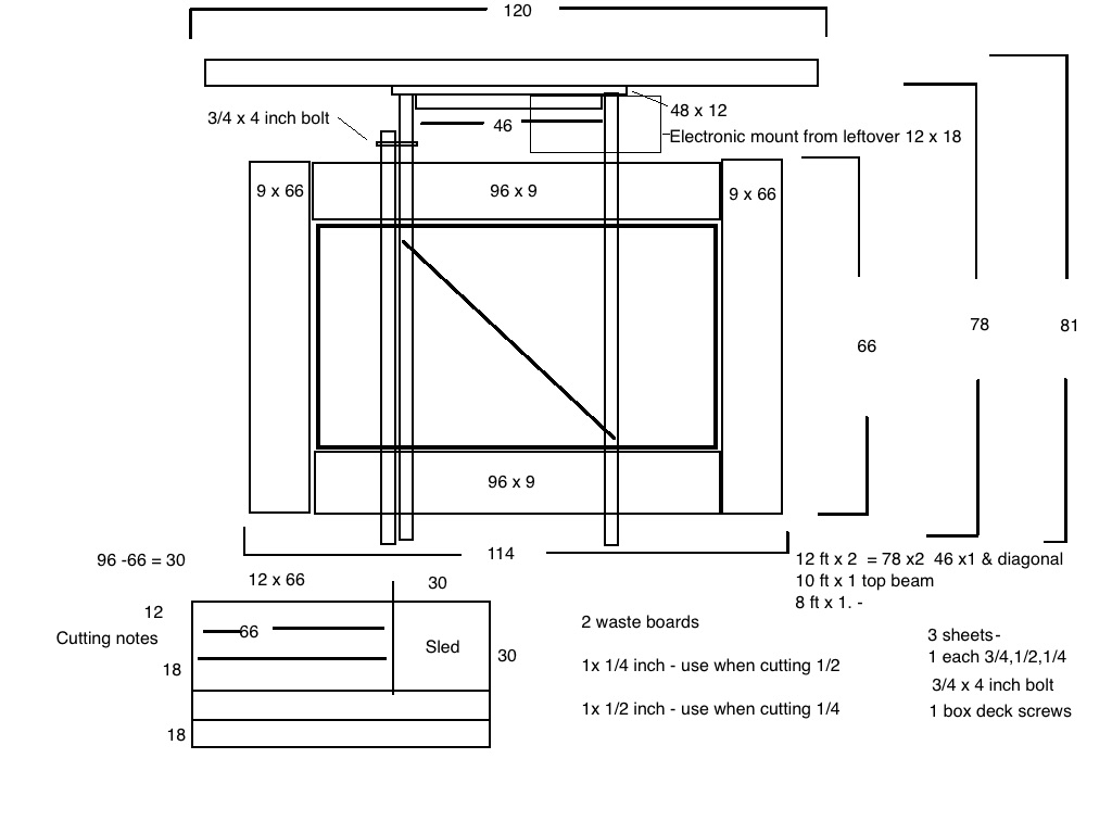

I’ve been working on a design to combine all the excellent ideas here.
So far I have a 2x4 top bar by default with an option for unistrut, something which is simple to construct (minimal measuring of critical dimensions), and something with mostly the same parts as the original design so that the BOM is not very different so anyone with a current frame design (like me ) can easily convert to the new design. I am close to having something I like, but I’m not quite finished. I will hopefully have a design to share for review tomorrow.

the single, offset rear leg scares me. It’s bad enough at the middle, at the
side like that it’s far too easy to apply force to the top right and have it tip
back.

I understand your concern. I see it as a strength not a weakness, I also want a 3 wheeled car. I’m deeply considering a full scale test. If I’m wrong I’ll change it. I’m interested to see what Bar is doing. So I’ll wait till tomorrow.

I agree that it makes sense to have a ground up design #2 and a retrofit top beam “1B”.
Also, there’s a 3rd type of frame builder. One who is going to go their own way anyway. Maybe they have access to more/fewer resources (time, money, space, materials, other tools) or maybe they have an idea they want to see to fruition (good, bad or otherwise).
If a single new frame has to be the only option, it should be a full on design #2. The cost of building a stock frame isn’t ridiculous, and I would expect many of the parts can be reused (plywood backer, brackets, some of the frame lumber).

To be fair, a lot of the stiffness problems we have been seeing have been due to
wood flexing, but the motor mounts to the arms would improve significantly with
glue.
and on my design, gluing the supports that stick forward for the top beam to
ride on to the rest of the frame should make them stong enough not to need the
angled braces.
I would not glue to bottom support beam or the plywood to the frame, they will
get chewed up by mistakes over time and need to be replaceable (again, a very
strong argument for not having the plywood be structural) but the rest of the
frame should be glued together.
