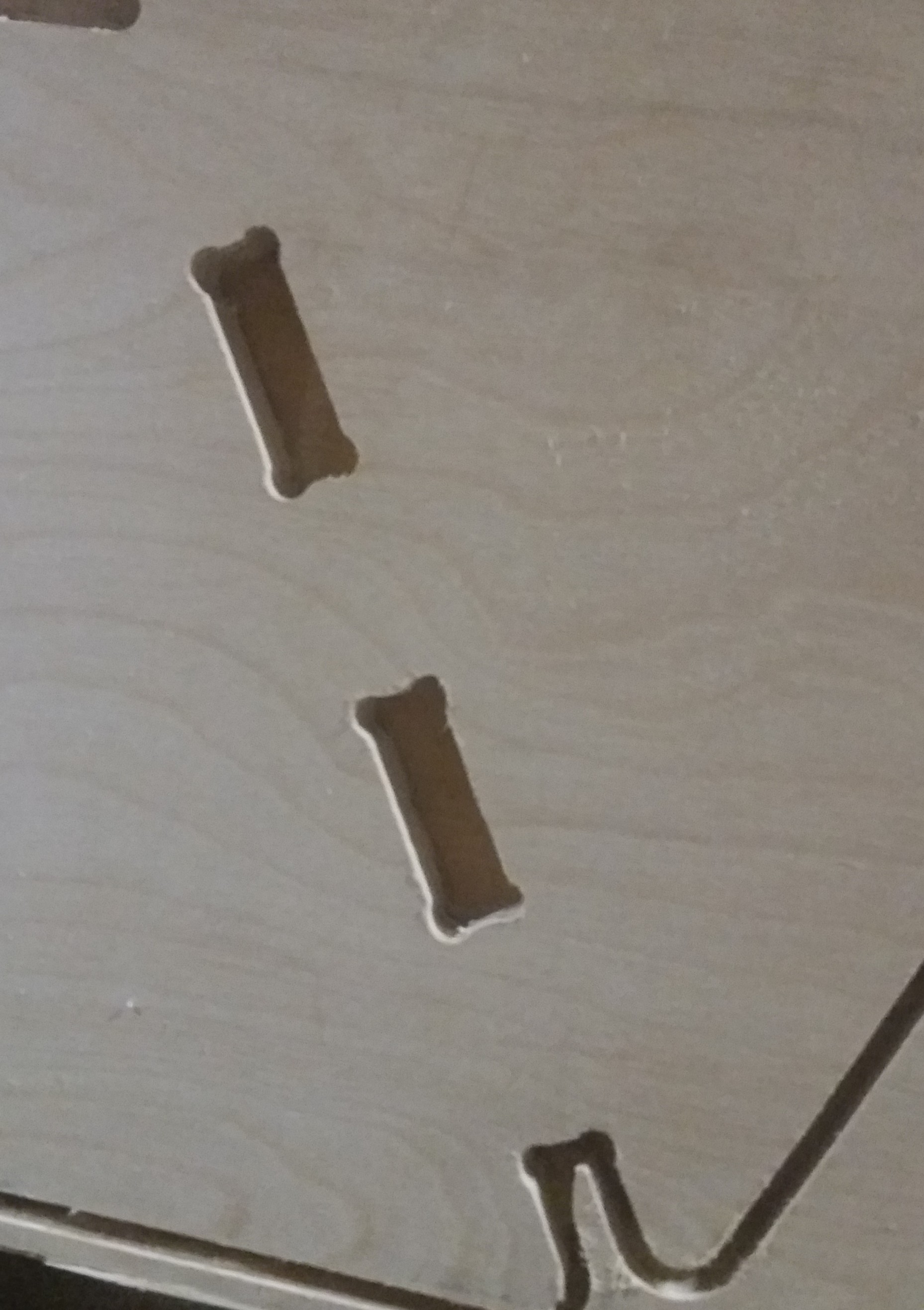

Glad that its working better for you. I did some cutting today and got the best results so far. Speed, or lack there of, is the key. Here are the settings I used:
On Contour and Pocket cuts use
Multiple Passes:
Max Roughing stepdown: 6.35mm (.025")
Use even Stepdowns: Checked
Feed Optimization:
Maximum Directional Change: 25 degrees
Reduced Feed Radius: 15mm (0.590")
Reduced Feed Distance: 10mm (0.393)
Reduced Feed Rate: 250mm/min (9.84ipm)
This will slow down movement to Feed Rate at Feed Distance measurement away (before and after) from any corner that is over Maximum Directional Change OR under Reduced Feed Radius. This was probably the most important thing I did. You can see the reduced feedrate displayed as yellow tool path in Fusion 360 preview.
Smoothing:
Tolerance: 0.01mm (0.004")
This will get rid gcode that uses distances that the Maslow cannot possibly achieve and so will reduce gcode size without sacrificing quality.
Bore:
This was way to slow but created perfect circles.
Ramp Feedrate: 300mm/min (12ipm)
Pitch: 1mm
You could probably quadruple the pitch and still get great results. With 1mm pitch it took 10 seconds to go down 1mm! I am going to do some testing on this next week.
Here’s today’s results:
Sorry for blurry pic. The Bore holes were less than 1/64" off. Look worse in the pic because or squirrel edges.
These dog bones did not have the corners pre bored. They were a one step pocket cut! The bottom knock off cut error was caused by lack of supporting material along bottom edge.
