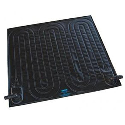

Maybe this violates the spirit of this project but what about using a cheap plastic or rubber solar collector that is already commercially available? You could still mount it in the frame for added efficiency.
There are many different designs and some would allow for auto draining.
Or maybe use cheap irrigation tubing that is already black, inert, flexible, and can handle being in the sun… Way cheaper than pex and the black tubing with thin walls will likely do a better job at transferring heat to the water than a pex/aluminum sandwich.

I’ve seen those swimming pool heaters in various forms as home water heaters but I don’t know about their longevity. It might be that a simple insulated box with clear cover would be a fantastic system… again, probably something that needs to be tested.

Looking at commercial equivalents is an excellent idea! One of those slap-my-head-and-wonder-why-I-didn’t-think-to-check-that kind of ideas.
I took a look on Amazon and the product you linked to only got three stars (on admittedly a very small number of ratings and mostly unhelpful reviews). One reviewer complained that theirs came apart at the seams which suggests that you would have to be very careful about the pressure you expose that product to. You would want to put it into an insulated greenhouse box to 1) protect it from damage, and 2) hold the heat in (reducing cooling by conduction, convection, and radiation)
