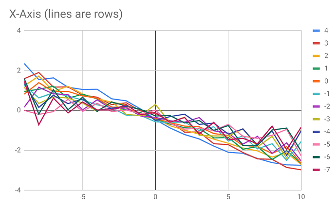

I ran through most of the calibration again (for -10,4 to 10,-7) and saved the values this time (since last time it crashed).
My y-values have some crazy periodicity across the horizontal lines
My x-values have a little bit of periodicity horizontally especially further from the center, but it’s not as pronounced as the y-values. I think this is a different issue than what you saw though since this is periodicity side to side – so the sled direction hypothesis doesn’t apply.
My columns had no obvious periodicity. See the doc for more detail.
I noticed a lot of chain slack variation especially near the edges. It seems my sled tended to stick to the board. I could see various levels of tension in my chain throughout the run. This could potentially account for some inaccuracy, though I’m not sure how it would account for the consistent periodicity in the Y-values though.

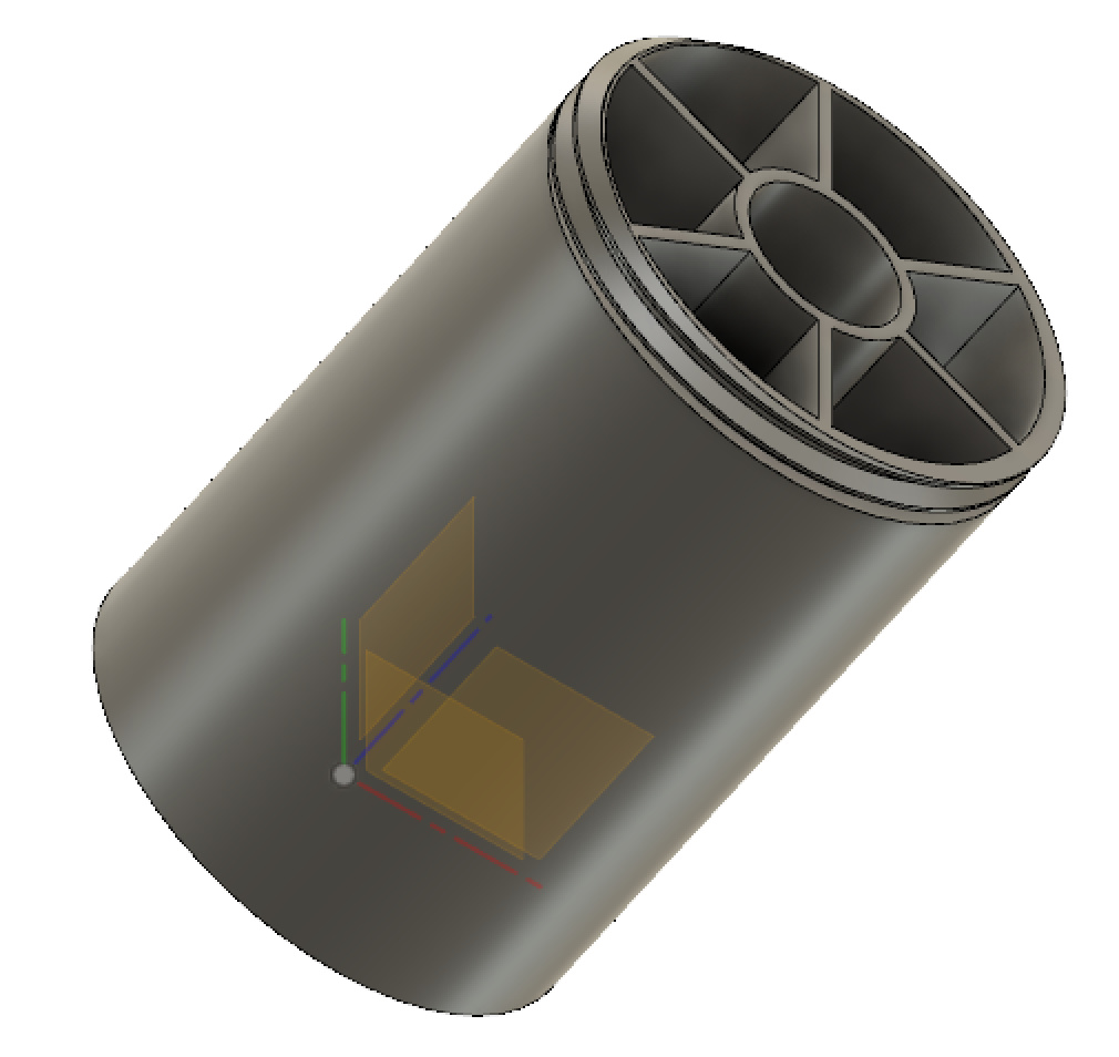

While waiting for the calibration to run I started designing a 3d printed camera holder I can fill with BBs to get to the same weight as the router (~6lbs). Here’s the Thingiverse link. I haven’t tried it yet. I think I’ll print it in PETG and go buy a bunch of BBs.

I’m not sure my periodicity was related to the motors… it could just be simple “hysteresis” (for lack of a better name). Getting periodicity along the Y axis is very interesting though.
I think some of what we are seeing can at least be associated with sled sticking… I have some HDPE to put under the sled to give it a try. The banner is not as smooth as the laminated blueprint, so that might be part of the issue.
