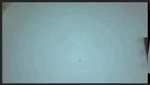

Watching this calibration run really closely I think this is the case. Frequently when moving to the next square I’m seeing the target point land high on one square, then low on the next, then high on the next etc:
Sep-30-2018%2021-58-59
I wonder if this effect is from the small vertical movements that happen during homing. When the target point lands high in the square, the routine slowly lets out some chain bit by bit until the sled makes it ‘close enough to the center’. But what I’m noticing is sometimes the sled doesn’t move down immediately, but instead the chains get a little bit of slack in them. I think what happens is when the sled then starts moving again, the slack is taken up and then the target point lands low on the next square. You can kinda see this in the videos I posted – you can see the chain bounce around a bit, even with the sped up video.
If this is the case, more weight and a lower friction sled could probably help. We could consider mitigating this by always lowering the sled below the target square and then slowly raising it until it hits the target center point. Though it would definitely slow down calibration.

I’ve seen it as well and it has been a concern of mine, but I figure that it really doesn’t matter because if too much chain is let out, when it finally overcomes friction and drops, it won’t measure to be within 0.125 mm error… so it will start taking up chain again until it does get into range.
The challenge then becomes sticking on vinyl with <0.5mm accuracy right?
I think I’m noticing an in-between state sometimes. Chain is let out, and the sled moves down a little bit, but not to the point that all the added slack in the chain is taken up. Then when the sled starts moving laterally again it falls a little bit and ends up hitting the next square a little low.
I wonder how the vibration of the router affects this in practice. My sense is that vibration would help shake loose any sticking friction and help keep the chain tension more consistent. I don’t really have a scientific way to reason about this though.
