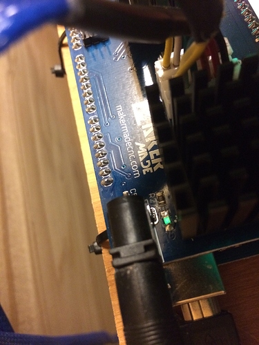

Looking at the powerlight it doesn’t shine as bright as the USB-light.
If I wiggle it around it lights up.
And to keep it like this I had to secure it with a cable tie.
I think I have a glitch in the Arduino Shield since it only works when I wiggle the contact and not the power cables.
After I secured it with the cable tie it worked fine.
However now I´m afraid that the power will be affected by the vibrations of my machine and the glitch will come back.

Hi Kim,
Possibly a connection issue between the motor and the shield.
unplug and reconnect both ends of each motor cable and then hit “test motors/encoders” under actions. If you get no failures then try the cut again.
If you own a soldering iron and know how to use it, or know someone, this sounds like it can be solved in minutes. A picture of the bottom of the motor shield (power connector region) could give a clue.

I would contact the supplier to a get new motor shield.
The cable-tie might look to work on a first glance, but can have unpredictable negative side effects.
For example, if the Arduino is mounted on the frame, the vibrations could cause on/off spices are not visible to the eye when looking at the led, put can be deadly for the electronics.
I would not operate a Maslow with a damaged shield.
