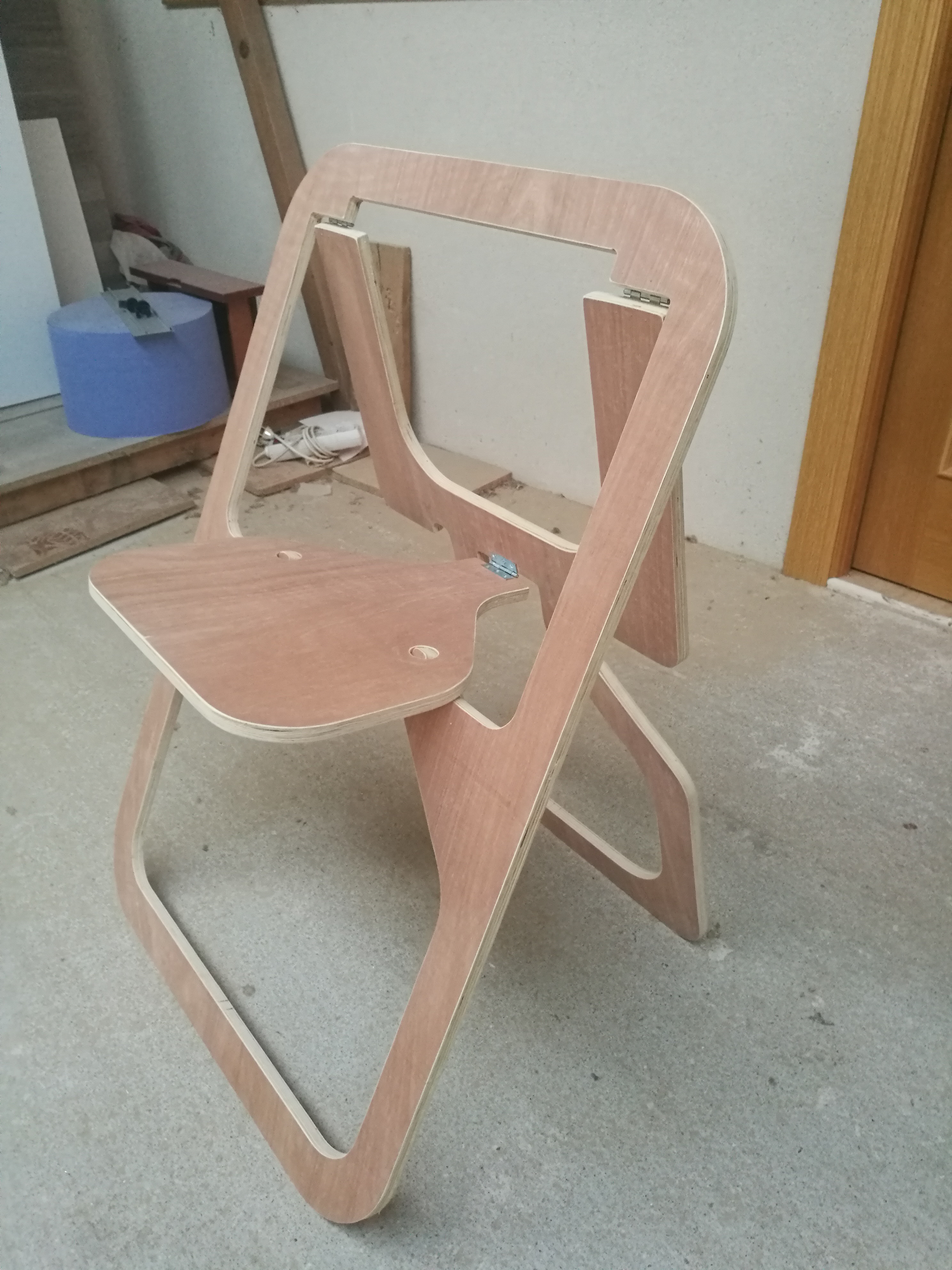

the machine work well, I’ve test to cut the chair that show in community garden, after some issues, I was able to do it. the problem is that I choosed a 15mm thick of board, so the chair is some unsteady
