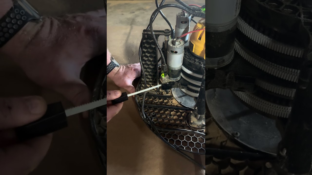

When I had this issue, the experience was that it was rigid when I would pull, and it would spool out more when I pushed in. I essentially would push, pull, push, pull, in tiny increments over and over to get it to feed out more.

clearer video showing the behaviour

I can confirm that pushing the belt in shouldnā€™t do anything at all. The only thing that I can think is that itā€™s either a timing issue or a memory overflow issue somewhere?
