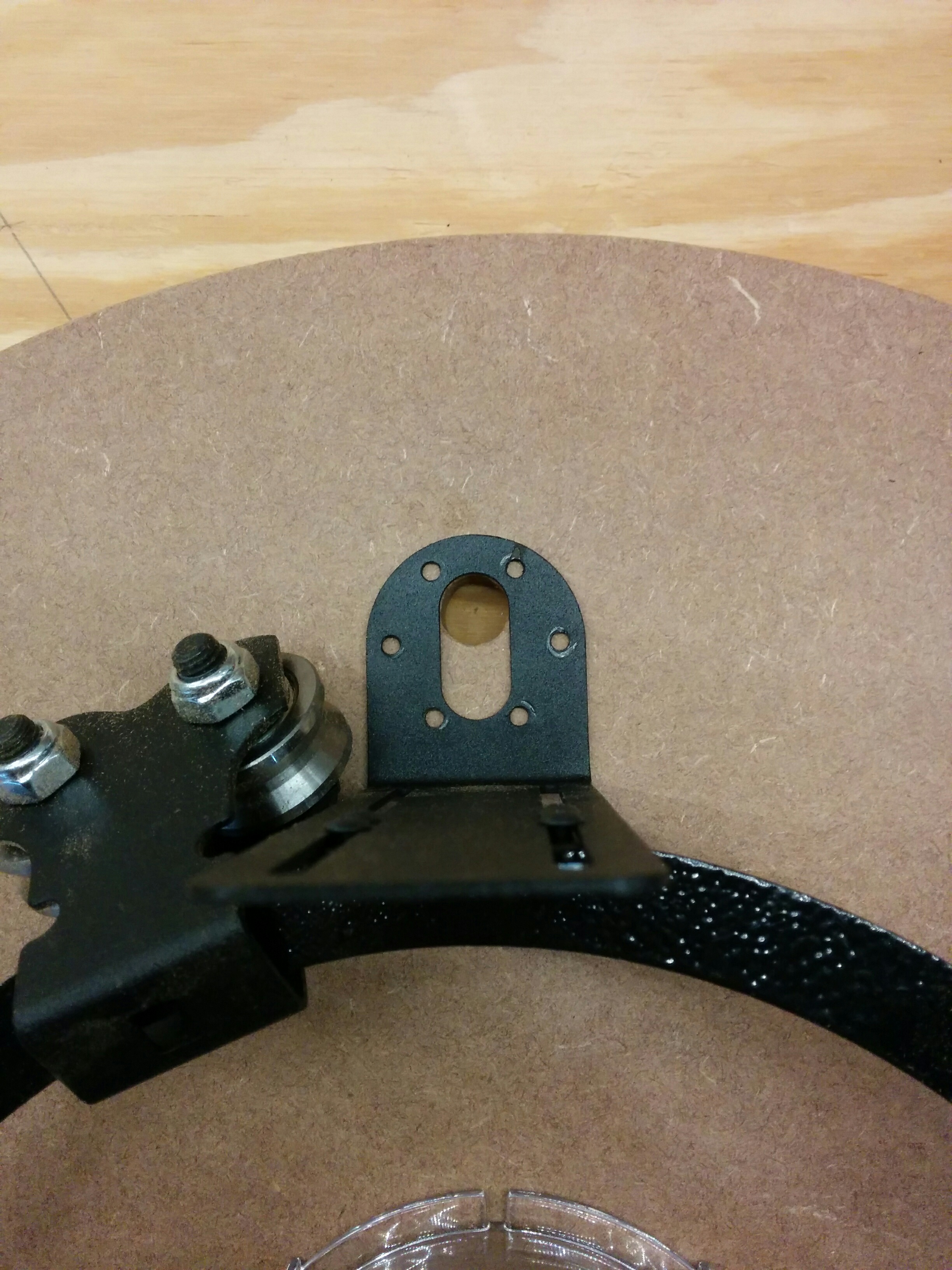

So I just cut my sled, and when I went to mount the ring to it I found that the alignment holes don’t quite line up with the bottom of the brackets. Here is a picture of one of the three holes with the brackets lined up with the holes the best I could get (trying to distribute the error across all three holes equally).
My sled appears to be dimensionally correct (almost exactly 18" diameter in both X and Y, the three alignment holes are all the same distance form the center opening). I’m wondering if this is actually an issue with the ring instead of the sled. Can somebody confirm if the alignment holes are supposed to match up with the end of the slotted hole in the mounting brackets?
What is the recommended procedure here, just screw down the ring as close as possible, or try to bend the ring to make it fit the holes on the sled? (I could probably screw the brackets down and then tighten up the bolts holding the ring to the bracket and it would bend the brackets a little and the ring a little…)

My instinct is that I trust the ring to be true more than I trust the holes to be in the right places, but if your sled is just right then I would expect the holes to be in the right places also.
You are right that the holes should align with the edges of the mounts:
One thing to keep in mind is that the holes are not an equilateral triangle so if anything is rotated they will be a little off, but as long as you are putting on your ring in the normal direction with the bricks down that shouldn’t be an issue.
Are all three holes off by that much? I can’t imagine that the ring is 1/4 inch out of true
To give you a better picture of the misalignment, I lined up the “top” (center) hole correctly, and then lined up the two bottom holes as best as I could and took three photos, one of each hole (starting at the bottom left, then the top, then the bottom right).
(Yes, brick holes are near the “open” end of the ring, and it doesn’t line up anywhere near the holes if I rotate it…)
I really don’t feel like taking all of the brackets and rollers off my ring to lay it on a piece of paper to check for circularity, but I did measure the distance between the bottom two inside corners at 8 and 3/16 inches, perhaps you can check that against a known good ring.
I plan on screwing it down without putting undue torque on the ring (I tested making it conform to the holes and the ring definitely was deflecting), averaging the error across all three holes.  It appeared to work just fine on my temporary sled, and I figure as long as I average the errors out the center of the ring will still be very close to the center of the bit.

I went ahead and used a laser cutter to cut out a cardboard template of where the holes are supposed to be on the sled, and held it up to the bottom of my sled.
Although the holes were not a perfect match, the cardboard template matched my sled a lot better than the ring brackets did.
