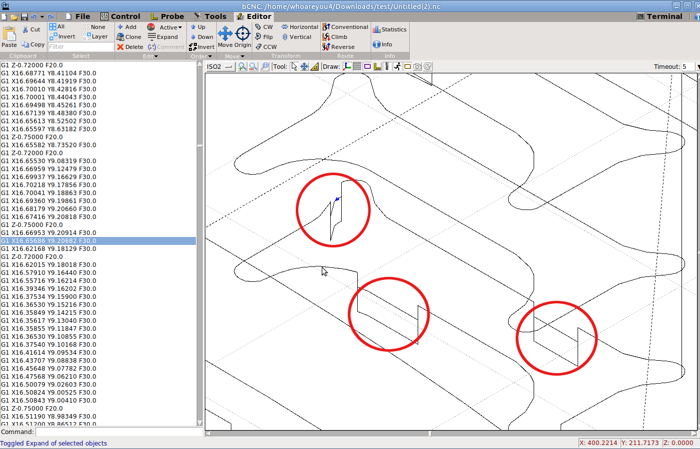

So I was cutting the stool, and it was coming out great until the top left side of the circles and it reall freaked out. I’m still not sure why.

I was watching it cut, and it did the error from the very begining of that side of the circle. It was cutting fine and once it reached that point the sled went straight down instead of around like a circle, and then it jerked around a bunch and eventually got back on track to making the circle.
I went ahead and let it do all three cuts just so I could watch it and see if I could figure out what was happening in that one particular area.

Was the circle that was cut out perfectly before done using the same file that didn’t work? If different, maybe its the file…
Yeah it’s a different file. The good one was a sled file. The bad cut was one I created from the open desk stool file
Would you be willing to post the ‘bad’ one? I’m trying to learn to spot things in a gcode file they cause problems like this.

Thanks for uploading the file! It certainly looks clean to me.

In GC there is a optical difference in the 4 cut-outs of the seat related to Z-moves.
in bCNC it shows as ‘spiky?’
in CAMotics it shows like this.
In the last 2 pictures there is like holding tabs in the pocket, the tabs are lower then the finial depth.
