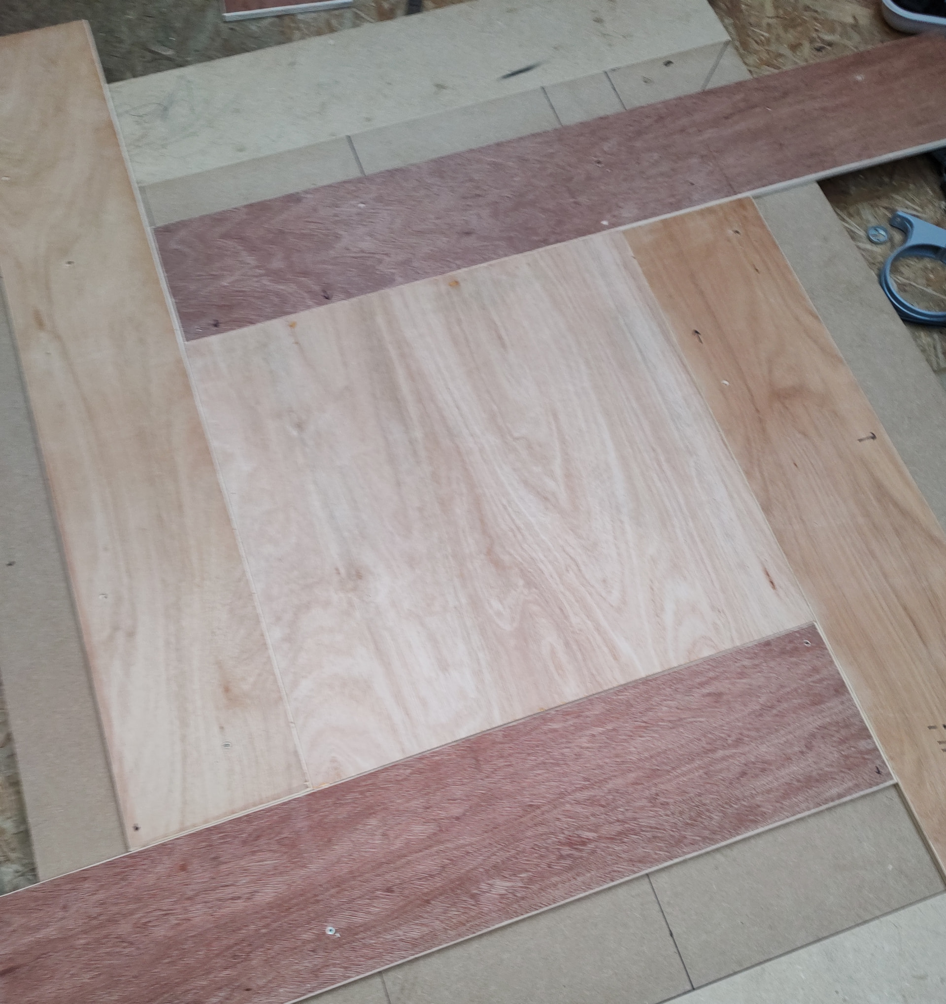

  • My waste board is screwed down into the X-frame - this means nothing moves round.
  • But also, I made a while ago1200mm*200mm boards in the thicknesses I tend to cut. These have a dual purpose:
    • They can be offset like this to hold any size workpiece, and screwed through to the frame.
    • They let you cut right to the edge by supporting the Maslow up to it’s edges.
And that’s about it. Works well for me, is very solid, and can be put away / set up in about 10 mins if needed.

note that you can set your wasteboard thickness negative as well.
when you add a bit to the machine, you will be moving the router up. on a large frame, that’s not significant, on my 30" square frame, if you add a 2" pen in the router, the belt angles in the Z direction get ‘interesting’ :slight_smile:
I’ll also note that you don’t have to do all this at ground level, I think Ian did it at tabletop level and used a table to hold his cutting material, with no frame from there out to the walls. in a small shed, you could have a fold out table to hold the workpiece at a convienient height.
good work with referencing the anchors against the wasteboard, it’s the plane of the wasteboard that matters, not whatever gravity says local ‘level’ is.
