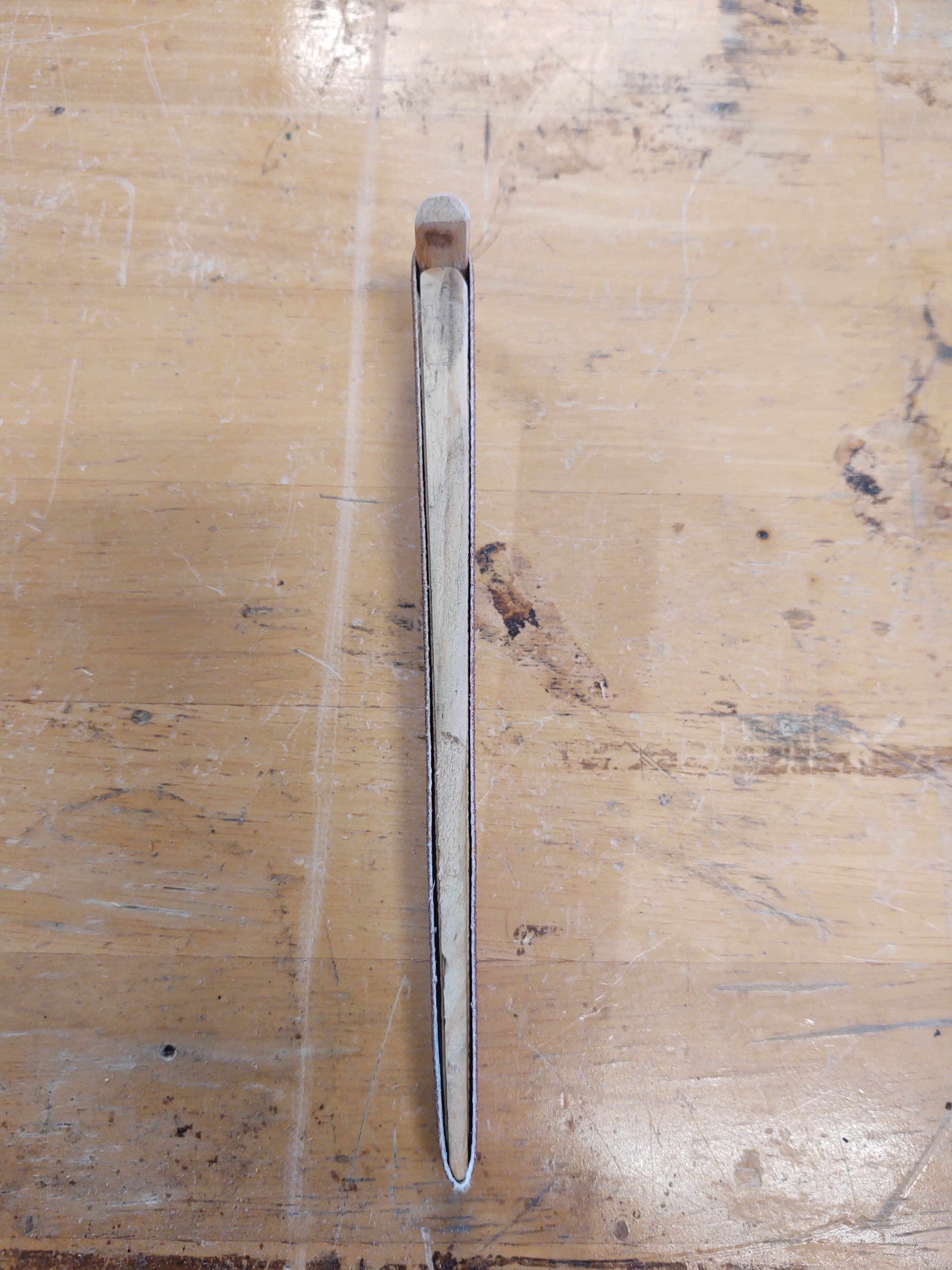

Homemade pencil sander.
Materials list:
Shim stock
Small sanding belt
Dowel rid
Cut the angled shim stock to fit the belt’s width, and a little shorter than the length needed. Use a small piece of dowel rod that is slightly tapered as a tightener. Make several, mark the side with the grit and rotate the belt on the pencil as the sandpaper wears out.
