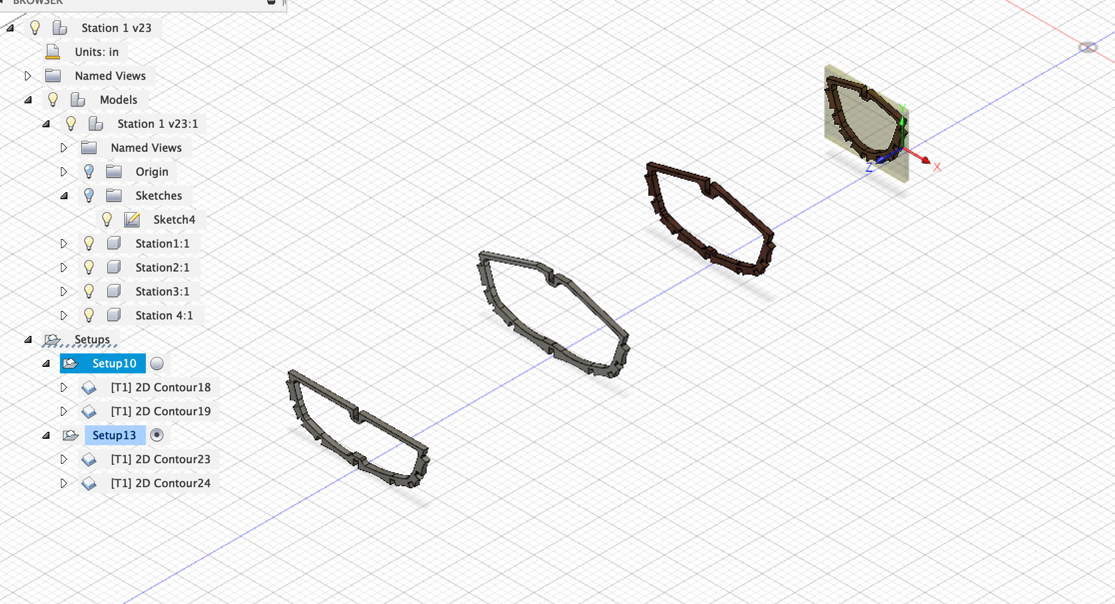

Drew out a couple more stations tonight and am working on a revision of the first.
Very cool! Are the dogbones on the longitudinals/chine logs on purpose or could you just trim round corners with a chisel (or round over the logs at the intersections)?

I could round over or chisel the corners, but I don’t want to. I could also scarf the joints, but it’s not a strip or plank built boat, so I don’t really see a need. Everything is going to be lashed and glued. It won’t go anywhere.
These are just test cuts so I can have a physical representation of what I’m drawing. When I built an actual boat, it will be made from 1/2" marine grade ply. The first one I built 8 years ago weighted only 25 lbs and was hand cut. I expect to shave a bit off the weight by optimizing the design a bit.
