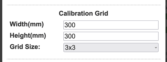

Lets try tweaking the size of the grid.
Can we try something super basic and little like a 3x3 grid that’s 300x300mm?
OK, sounds like a way forward. I’ll try that and let you know results. Thanks for the assist!
Just tried this twice. The calibration started low on the board, a third off the edge, ran for maybe 30 seconds, stoppped with a red flashing light, no real error messages I could see (the first Log)

Tried one more time and got a surprising number, then a STOP - at the end
[MSG:INFO: Center point deviation: TL: -0.032 TR: -0.028 BL: 130.508 BR: 13.582]
[MSG:ERR: Center point deviation over 100.000mmm, your coordinate system is not accurate, adjust your frame dimensions and restart.]
