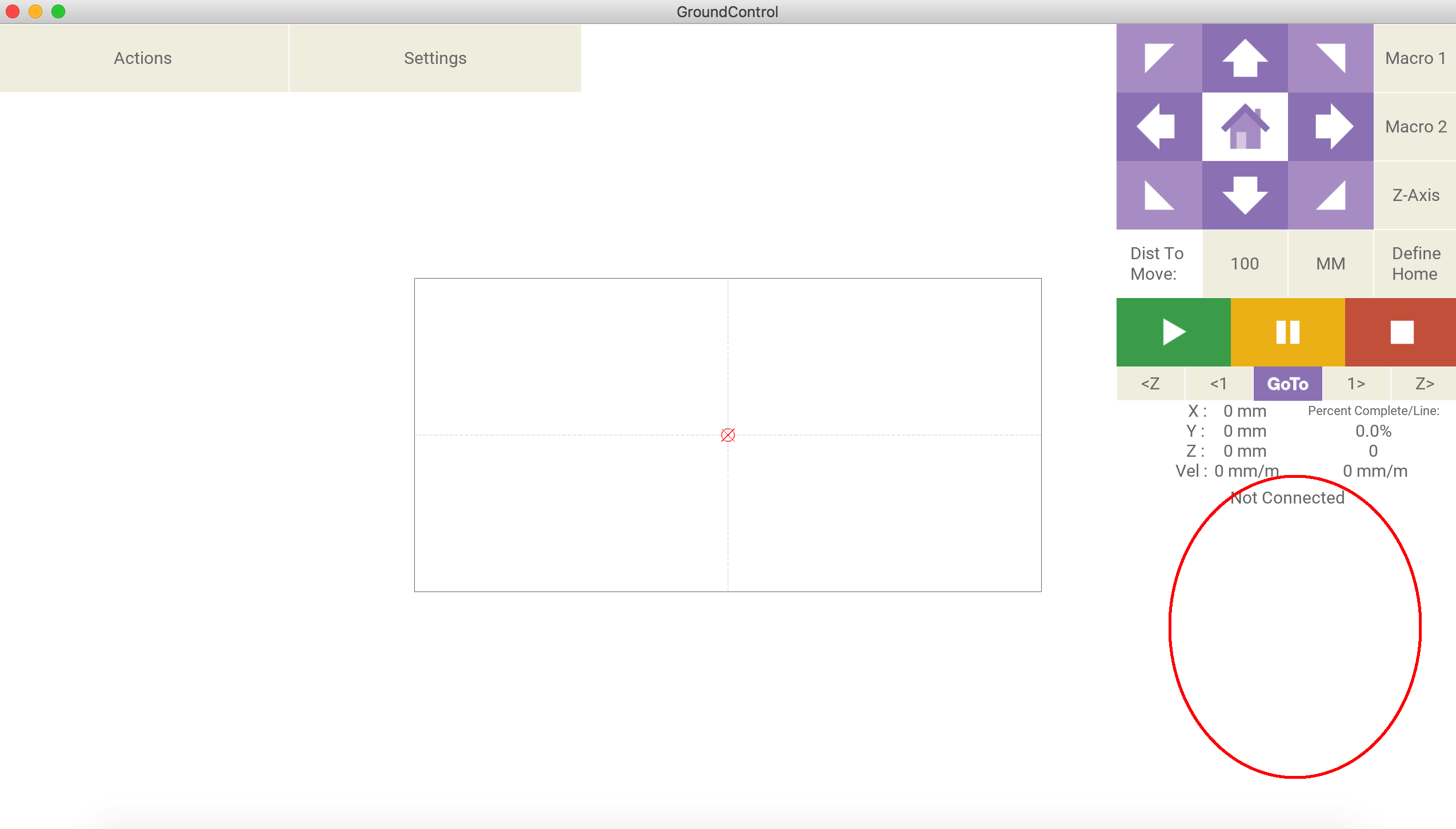

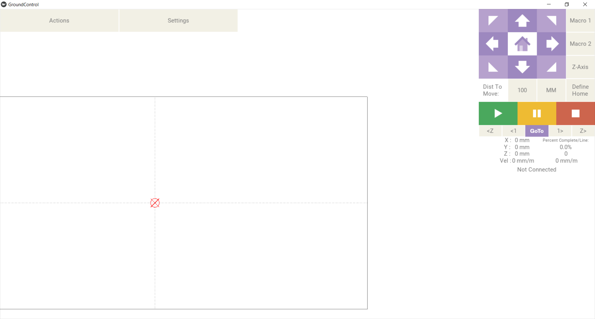

Thank you for the information so far. I was looking for a screen like the one below - right after Ground Control opens. I’m interested in the information shown in the lower right where the red circle is in the picture shown below. Can you send a screen like this?
Ok, almost there! In GC, on the Actions screen, first click ‘Update List’ then click ‘Ports’. On Windows, the proper choice is usually ‘COM3’. Highlight that and click ‘Connect’. If we chose right, you’ll see ‘Connected on COM3’ and other lines, and after that you’ll be ready to go.
