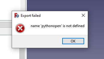

Hi there, Im getting a “name ‘pythonopen’ is not defined” error when atempting to export using the maslow_post… can anyone help with this?
Hi there,
I’m not totally sure why, but there is code to create a function called pythonopen which is the same as the built-in open function. According to the comments, this is to avoid confusion with another open function defined elsewhere. However, I can’t see the other open function.
So, two suggestions:
  1. If you are using Python 3 then try changing line 101 in maslow.py from
    if open.__module__ == '__builtin__':
    to
    if open.__module__ == 'io':
    This will force pythonopen to be declared, but doesn’t actually do anything to explain why it is necessary.

  1. Unless someone can explain why that is even necessary, try changing line 219 from
    gfile = pythonopen(filename,"wb")
    to
    gfile = open(filename,"wb")
You are probably using Python 3, which is why the if statement in line 101 returns a different value, which then causes pythonopen to be undefined. However, as I said, I don’t really know why that is even necessary. Unless someone can explain it I’d remove the if statement at line 101 and 102 entirely, thus removing pythonopen completely, then modify what was line 219 as suggested above.

suggestion 1 and 2 both gave me this error image
I am using python 3.8.4 on windows 10.0.19041 freecad 0.18

Ok. It’s to do with the differences between Python 2 and Python 3. Since Python 2 is deprecated we should all be moving on to Python 3, however, that requires programmer effort to drag every single piece of code up to the new version.
If I have time I will have a go, but in the meantime anyone else is free to do so, since the problem is obvious and the solution is clear. :slight_smile:
I fixed that for the Maslow post-processor. Except, you won’t see that because it’s not working for you for other reasons at the moment.
Thanks… Where can I get that? i’m not seeing it in Github.
Where can I get what?
The latest maslow.py in Walt Moorhouse’s Github has the mm/min fix. However, that script is working for you at all because it’s not been updated for Python 3.
