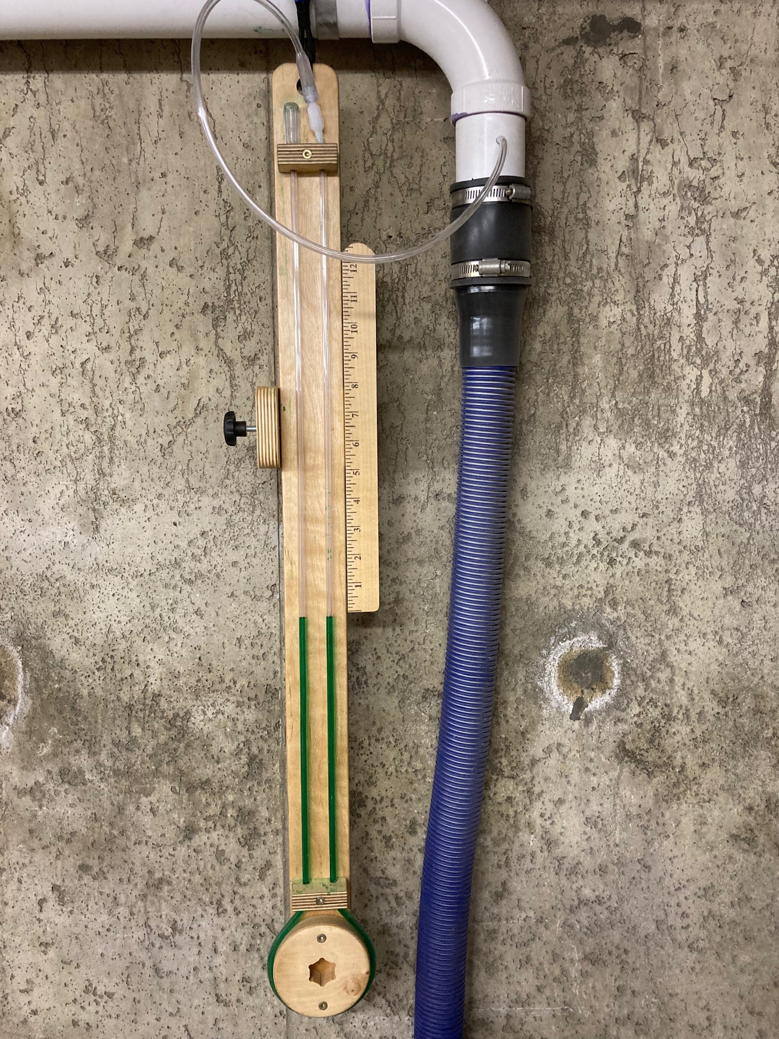

Since you already have the hard pipe pvc in place. Consider adding a simple U-Tube manometer to the vacuum line. its a good way to make sure you are not overloading the shop vac and starving it of too much airflow. I have one on my dust collection system and it really helps to regulate the air flow.
Here are a couple of pictures of the manometer I use for my vacuum based dust collection system:
The first picture shows the manometer at a steady state with the system off. The second shows the liquid level difference with the vacuum on. Idealy the scale used would be large enough to measure the total displacement of liquid level between the pressure side and the atmosphere side. My scale is shorter because of … reasons. The scale is also in inches but in reality the scale used doesn’t matter because what you are after is a RELATIVE change indication anyway. In my case, I know that when the suction side of the manometer is less than 6 inches, I can run the vacuum for hours without it tripping out it’s thermal overload. It also provides me with adequate suction for my needs. In your case, You can use it to monitor in real time how well you suction is being maintained or lost during your cuts and you can also use it to balance the suction between your router and table. Also, these can be made pretty cheaply with some wood scraps, vinyl tubing, and distilled water with food coloring. Just make sure your scale can be moved in order to zero it out. The water in the tube will evaporate and you will need to slide the scale to adjust it to compensate.
That is a very cool piece of equipment. Will definitely be adding one to my system.
