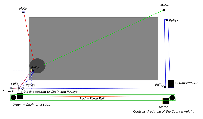

An idea that I have bantered around for 3+ years, but never achieved, is a 3 chain system with a passive counterweight. In theory with three chains, nothing is ever over constrained. I have always thought of this design as a “vectored gravity approach” in a way moving the angle of gravity on the sled to keep both chains in tension. My hunch is that an angle in between the two chain angles is ideal, but I am not smart enough to know how to calculate this.
Anyways, here are two drawings of the idea. I am happy to discuss it if anyone wants. The vector of the passive counterweight is controlled by a 4th motor on a slide.

The problem with this approach is positioning the slide across the
bottom (remember sawdust and chips will be falling on it) and how much does this
complicate the math of figuring out where the sled actually is based on the
motor positions (since you now don’t just have gravity pulling on the sled, you
have this additional force)
our movement speed is limited by the available force of gravity in the bottom
corners, but our accuracy is limited by the accuracy of our mathmatical model of
the machine. I’m not convinced that we are properly modeling chain sag/stretch,
adding an additional force complicates the model more.

the problem is that weights provide constant tension, if you have constant
tension, then lines to the bottom corners won’t work because the angle to the
far corner is going to be flatter than the angle to the near corner.
This will produce more pull towards the far side than to the near side (break
the tension down into a vertical and horizontal component and you will see what
I mean), this will pull the sled in the wrong direction.
