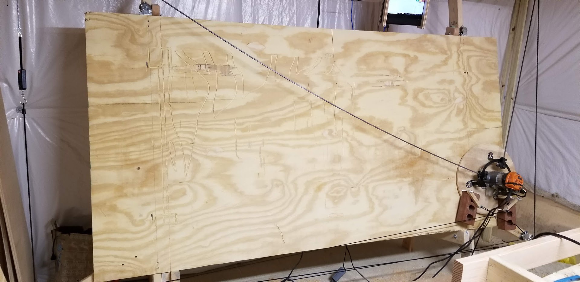

Thanks again @dlang for your clarification and guidance! We did the following:
  1. Added three coats of paste wax to our new wood Maslow sled (old sled had some)
  2. Flipped cotter pin around as sometimes it catches and lose 1/2 inch. Moved screws out to make sure bearing guide on ring kit can go all the way over, gained 1/8 inch.
  3. Two cuts near corner at 35 ipm actually finished without complete failure - although a bit wobbly. (Top right missing corner would have been fine, bad estimate of where to start)
  4. Third cut near corner at 5 ipm actually came out perfect :smiley: Maybe next test will be 10, dunno.
So we can now cut small items in corner areas as long as we program/CAD in Easel or Makercam to go slow.

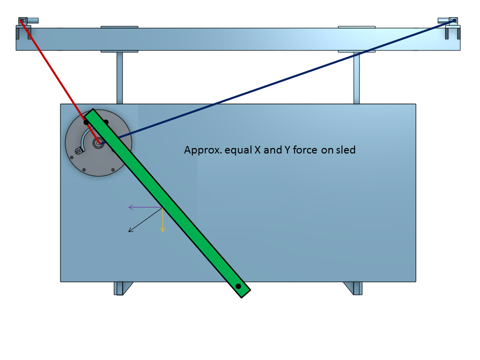

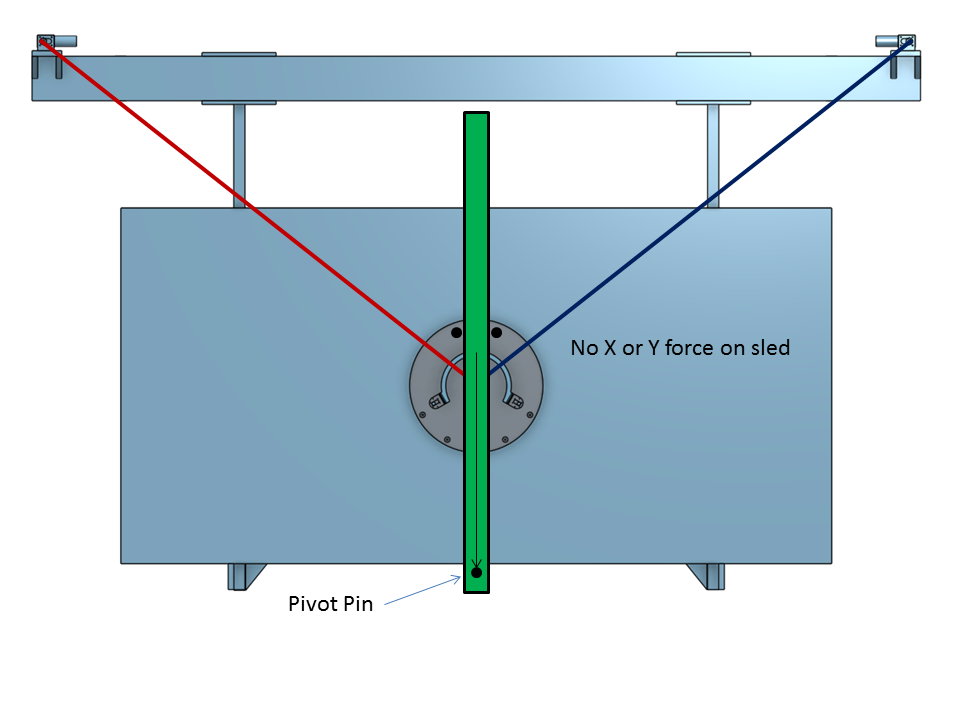

Don’t immediately dismiss this idea because it’s impractical. I’m trying to take the conversation in a different direction. I’ve got the start of an idea, I want to see if anyone can make something of this concept. Use the idea but move the pieces around to make it practical.
What we need is something that acts like a magnet or gravity on both right and left side of the Maslow. Something that pulls more as the sled gets closer and pulls less as the sled moves away. The opposite of a spring. I’m thinking about using gravity itself. Using a board that rotates about pinned joint and connects to the router sled with some rollers (or similar). As the sled moves away from the center line, the board creates a moment about the pivot pin and applies force to the sled.
On the center line the board is balanced. The resultant force on the sled is 0 because it’s all resting on the pin.
Slide1
At the top left, the resultant force is 45deg.
At the bottom left, the resultant is almost all in the Y but with some X.
This design obviously wouldn’t be practical as-is. If it could be relocated to hang off the chains somehow on the backside, and we could flip X and Y components at the bottom left, then we might have something to work with. Any thoughts?
