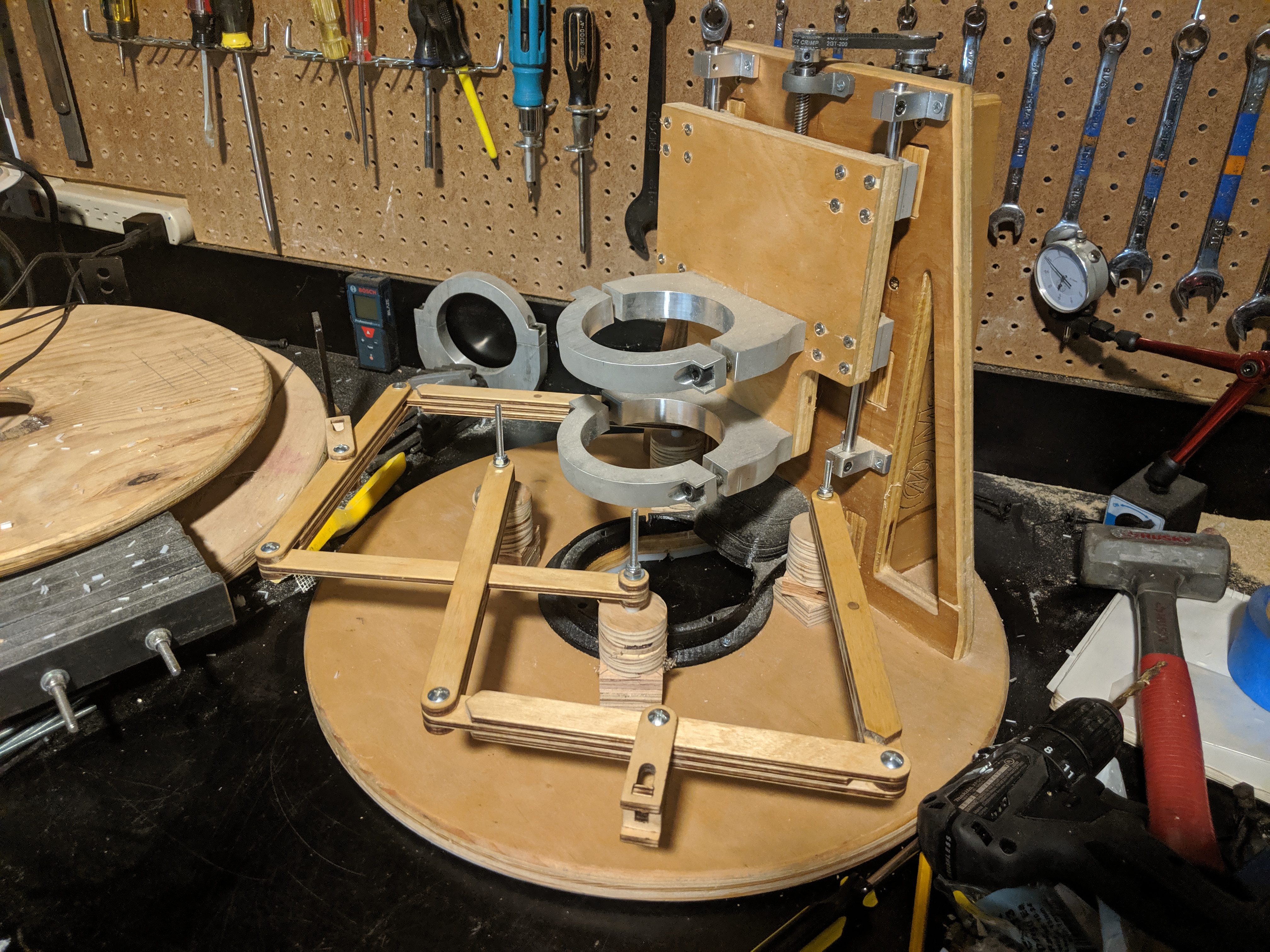

This week I did manage to get a new, adjustable top beam mounted up on my frame, so I can now pick up where I left off on post 206 with my spindle clamps. :astonished:

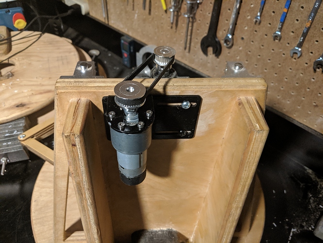

Tonight, I got my linkages mounted:
And my Z-axis motor mounted:
The motor bracket I cut on the waterjet at work, and used a press brake to get the 90* bend it in. Made it a breeze to get a good tension on the timing belt. I used 10-24 threaded inserts into the plywood, because I will be adjusting that tension a lot when it comes time to test different ratios.
Speaking of ratios, I am currently running the set of pulleys that give me closest to 1:1 from what I have on hand, just to get it up and running. The motor is running a 40 tooth pulley, and the leadscrew a 30 tooth pulley. This gives me a ratio of 0.75.

The Z axis has so much more resolution than is needed that you could have a 10:1
gear ratio and not notice any loss in accuracy (you could probably get away with
a 100:1 ratio)
