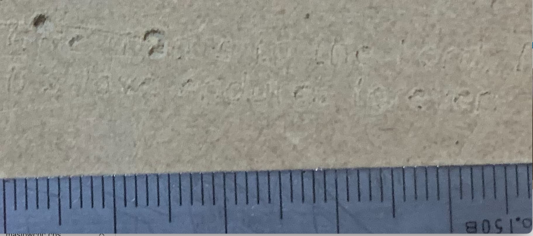

I did a test cut on the waste board because i couldn’t wait to see roughly what it could do. Also couldn’t even wait for it to finish, just stopped and moved the sled to take a closer look. I was testing a failed experiment prior to the upgrade where I didn’t realize how small the text really was (3mm tall), figured this would be good to throw at the meticulous. I know it’s not the prettiest pic, but can you see the potential! I’m very pleased!
The engraving is in the second photo too, just too tiny to zoom into.
