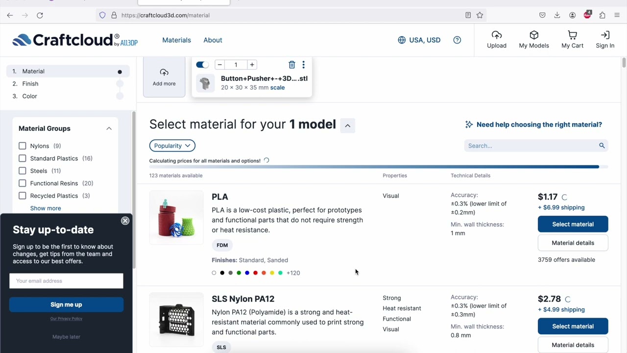

Hi Guys,
Getting a quote to have some of these things printer, I have no clue about the different materials, what are recommended for these?
1 of https://www.maslowcnc.com/s/Button-Pusher-3D-Print.stl
1 of https://www.maslowcnc.com/s/Dust-Hose-40mm-Festool.stl
4 of https://www.maslowcnc.com/s/Triangle-Anchor-3D-Print.stl
Thanks,
Bill

PLA is the basic material, sort of the default in the world of 3D printing and it should be plenty strong for all of those parts.

For anyone interested, in NZD the printing worked out at:
$64 - 4 x anchors
$21 - 2 x push buttons
$71 - 2 x dust host manifolds (40mm)
He did have an issue with one of the pieces
In regards the error, I have attached screen shot. The layer height in view is the area in question.
PS says that the object might be reoriented to fix the issue. PS has become picky recently.
I’ll still fix it with Fusion 360.

Good find! Thanks for sharing. They are also cheaper there which is nice.

Just collected the parts I had printed. He said all the supports came off cleanly and thought they were well designed.

Pla will warp in a hot garage or dorect sun light. , best to use abs if you operate cnc in hot area

PLA is the "standard: filament but I highly recommend PETG at the least, ABS or ASA would be even better. If you’re using this outside where it will get UV exposure, ASA is your go to filament.

Thanks for the comments, this will be used in my garage, not in direct sunlight. Temperature in there is highest during the summer, max around 34C. Will see how we go
