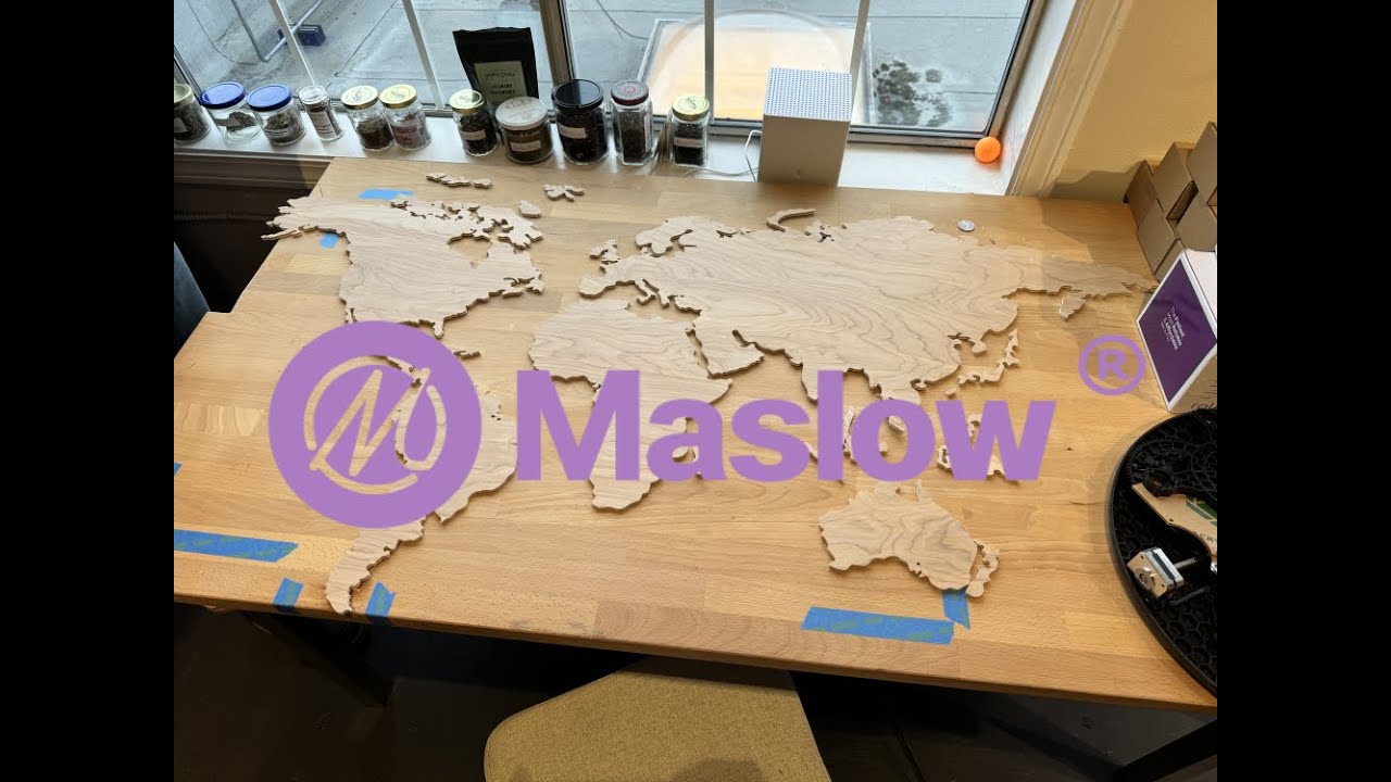

Nice video and writeup. What speeds and feeds were you using?
Great question! That was 1800mm/min and 3mm depth of cut with a 1/8th inch router bit.
Edit: But because of accelerating into and out of all the fine details the machine was actually moving slower than that for a lot of the time

That sounds around twice the feed as the original. How fast can you push it and have you tested it?
Maybe some tests of the same shape at incremental feed rates to judge when accuracy and quality start to diminish. (of course spindle speed will have to be adjusted appropriately)
I have a couple, but you can get 1/8" straight bits (I have single flute). That would help a lot with your tear out and fuzzies in plywood.

try using a stright bit instead of an upcut to reduce pullout (it won’t
eliminate it, but it will reduce it significantly)
@bar Have you tried cutting plywood with a compression bit?
For anyone that hasn’t heard of them, the tip of a compression bit has a spiral up cut while the rest of the body has a spiral down cut. That means the bottom and top surfaces both have less tear out, especially for plywood or other types of laminated materials. Katz-Moses has a nice overview video with high speed footage showing the differences.

2500 is the software limit right now, but that number is kind of made up. I’m sure that it’s possible to go faster than that. This was with a 1/8th in router bit so I think it would probably break if we pushed it much faster than it was going, but with a 1/4th inch router bit quite a bit faster would be possible.
Everyone who suggested a straight bit or a compression bit, those are great ideas and would probably help quite a bit. I haven’t seen an 1/8th inch compression bit in person, but a quick search shows that they do exist :grinning:
compression bits only work if you are cutting full depth in one pass. Bar is
rather conservative in the depth of cut that he tries, so if he used a
compression bit, it would be an up-cut bit (tearing out the top) before the
upper part came into play
if you do a finishing full-depth pass, then they can be useful.
Good point. I’ve been able to cut 1/4" plywood full depth in one path as long as the speed is reasonable.

I would commonly do 3/4 ply in a single pass with the original maslow (keeping
the feed rate down and/or arranging the cut direction to be towards the motors)
but bar tends towards 0.1 or 0.2" per pass
I didn’t see all of the other suggestions for compressions bits on the Kickerstarter updates, I guess I need to start reading the comments there as well.
I saw you asked for recommendations on bits. https://www.cadencemfgdesign.com/shop is a small shop that makes various bits in the US. I bought some after hearing good reviews and I’ve been pleased with them. They have a 1/8" compression bit that has a shorter up cut tip vs. most others I’ve seen: https://www.cadencemfgdesign.com/product-page/mini-jenny
