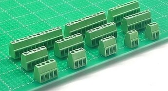

I am not a specialist and may be very naive.

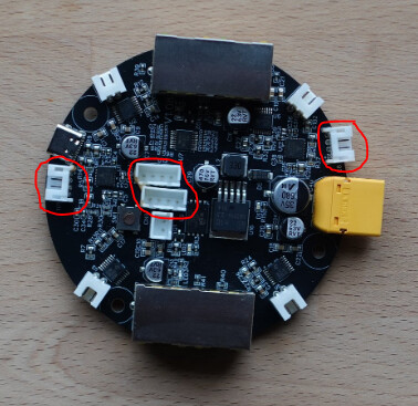

Why not using basic plugs, already used on the controller board (JST connector ?):
Cables could be similar whith the Z stepper motors.
Also, the cables could be soldered to the encoder board, to remove 1 interface.
Or if we need stronger interface, we could use “PCB screw terminal block connectors” for example. With or without plug.

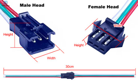

And may be tried on existing units, the following DIY solution:
Again, please don’t try my naive ideas on your maslow, unless it is confirmed by suitable people.
(I don’t even own myself a Maslow 4 (M2 owner))
Remove the ethernet female connectors from the boards (desoldering) and directly soldering new wires on the controller and encoder doards. A simple connector solution can be chosen in the middle to allow mounting/dismounting.
(I guess basic connector in the middle of the cable will be less subject to problem with vibration?)
But we will need wiring instructions (which terminal on controller board goes with which terminal on encoder board).
https://www.aliexpress.com/item/1005006898618054.html

I like Juju’s idea of using similar connectors to the ones are already used for the motors. But I’m legally blind and have no soldering skills (I’ve tried soldering a few times but it has never ended well lol). So hopefully Bar can come out with new boards and encoders that use a different, more robust connection type. I would definitely buy them (once my savings recovers from buy the M4 anyway).
