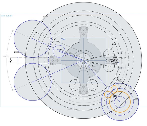

This is my CAD model that I use for checking mechanical fitness
you could have something that sits in the center of the existing arm and holds a couple bearings (the orange circles reflect this) and have a slot (shown by the large dotted lines) that the bearings ride in
It could work, and for a PoC it sounds like a good idea, but I think you would
be better off planning to use the motors/encoders, but with new spools instead
of re-using the entire arms (move the motors to the center of the spool and eliminate the gears and all that headache) (100mm spools would give you better-than-stock red zones even with the towers)
if you count on the arms sliding in the track, you don’t need them to swivel, which makes it much easier to adapt/design them
The only real problem would be the vaccum, and depending on how high the ring is, you may be able to get in under it for that
I sketched up this option
two part ring segments with holes that match the sled (did not include standoffs, don’t know what height above the sled would be correct)
two part adapter that goes in the middle of the arm and has pegs on it for bearings. should just need a bolt or two in the middle of the arm to hold it together.
